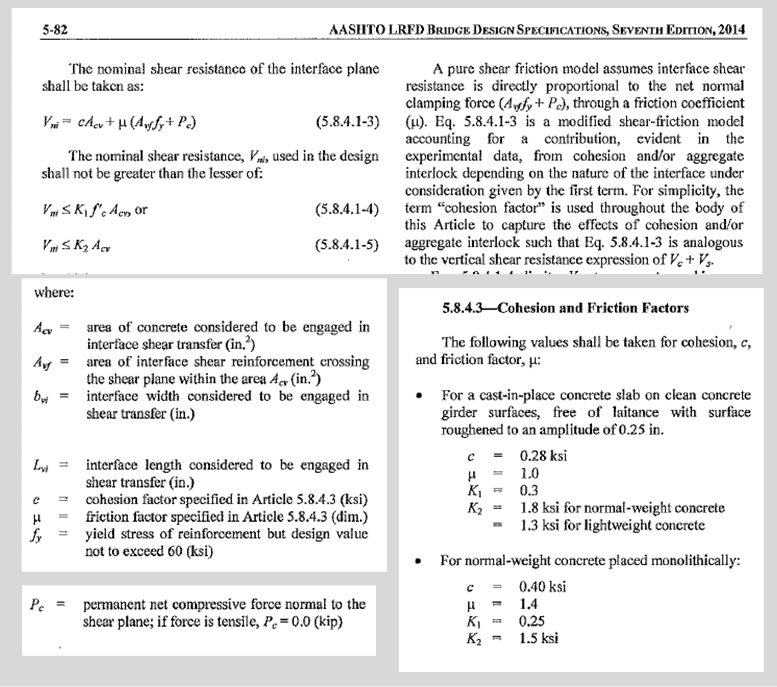

AASHTO LFRD Bridge Design Specs 2014 page 5-82 and following (included as PDF pages 1297 and following of the FIU "Final calculations" PDF):

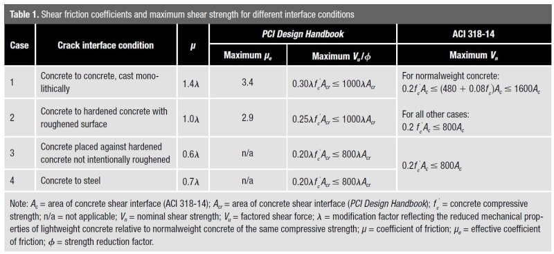

Precisely. This code tells you how to calculate shear resistance via frictional force transfer between surfaces of steel or concrete that are cast or placed as separate or joined entities AND THEN CLAMPED TOGETHER. By contrast, my point relates to poured concrete reinforced with internal steel rods or cables, like in the bridge that collapsed. Nowhere in the design codes for such reinforced concrete does internal concrete "friction" provide any credit for reducing the amount of steel that must be provided to withstand tensile shear forces within the structure. As you can see, THERE ARE NO CLAIMPING FORCES in this bridge structure (and certainly not in the vicinity of the failure cracks that were observed). So, I am not "discounting the Shear Friction method described in ACI 318 as 'not really friction'." What I am asserting is that in rebar reinforced concrete design (where there are no clamping forces), concrete friction is not a factor for reducing the steel required to withstand tensile shear forces. If in fact the design of the FIU bridge relies on "friction," internal to the concrete poured to make up the bridge, in order to reduce the shear steel requirement, then that would certainly go a long way to explain why it collapsed.
See for example the following table which exemplifies the kinds of interface where it is appropriate to consider friction between opposing surfaces. Category 4 is not rebar reinforced concrete.
FortyYearsExperience said:
See for example the following table which exemplifies the kinds of interface.
Sorry, I'm not clear on the point you are making. Are you saying that this table covers the case of the FIU bridge? (If so, which of the listed Cases apply?)
Or that the table covers cases where friction applies, but that it does not cover the FIU bridge? (If so, why does it not apply?)
Thanks.
The table covers cases where friction applies, but it does not cover the relevant part of the FIU bridge because the shear plane that had the highest shear stress in the FIU bridge (namely the condition that is the subject of my 'back of the envelope' calculation above) did not include any clamping force. The mere suggestion that any code permits reliance on a "friction" force supplied by concrete to reduce the tensile shear steel demand in such case is nonsensical.
The table covers [...] does not cover the relevant part of the FIU bridge because the shear plane [under discussion here] did not include any clamping force.
As I understand it, the "clamping force" scenario is where the interface is rough to some amplitude, so that if shear is to occur, the mating bumps and valleys would have to ride up on each other, which would create a separation across the interface and thus meet the tension force of the rebars that cross normal to the interface. So the rebars would be designed to supply adequate tension (as oppose to sheer per se), and also must be sufficiently developed. It is that tension that's referred to as "clamping force"
On brief googling, whether or not to add externally applied force as part of the force normal to the interface (resisting the "riding up") is a subject that appears to have developed over the years. For example:
"Examination of shear friction design provisions" [URL unfurl="true"]http://scholarsmine.mst.edu/cgi/viewcontent.cgi?article=8759&context=masters_theses[/url]
... notes:
"The equation for the nominal strength of the interface given in the AASHTO LRFD [2016] provisions is provided in Eq. 2.5. [...] The design for interface shear transfer in the AASHTO LRFD provisions is quite different compared to the ACI 318 code and PCI Design Handbook [...]. Pc accounts for the addition of any normal force that is applied to the interface (compression is taken as positive in the equation). Pc is added to the clamping force, Avf x fy, since both forces are acting normal to the shear interface plane. [...]
Vn = c Acv+ mu ( Avf fy + Pc) (Equation 2.5) "
I'm not versed enough in this discipline to know whether this is good, bad or indifferent. But it does look like it's an accepted idea in some circles, and corresponds to FIGG's calculations, albeit with (I believe) the wrong input numbers.
This academic thesis makes it quite clear that the notional "friction" produced in the concrete is a factor that allows for greater shear stresses to be accommodated in the concrete. This analysis is silent on the question of any reduction being allowed in the required tensile/shear steel. As my "back of the envelope" calculations show, the tensile/shear steel provided in the bridge to tie diagonal #11 to the deck was wholly inadequate. About 27 square inches of tie steel was required (absolute minimum). Whereas, 5 square inches of stirrups were provided, and they were not long enough to develop any tension force. The FIU/Figg calculations referred to "friction" in the concrete, but that is irrelevant to the question of required shear steel.
