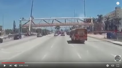

TheGreenLama said:
And in one of the earliest posted videos by Tomfh in Thread I, 18 Mar 2:42, member 12 actually looks, of all things, to be pulled inwards.
I think there may be some confusion over the motion of #12 because behind #12 there is a tree. As the vehicle and camera moves, due to changing perspective the tree moves rightward relative to #12 in the foreground, possibly making it look like #12 itself is moving.
Here's a frame from earlier in that video: , in which the tree in question can be seen to the left of #12.

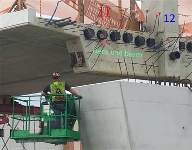

Regarding 11-12-deck, I wonder if a structural engineer might comment on how such joint systems work typically? What they might expect to see inside this bridge?

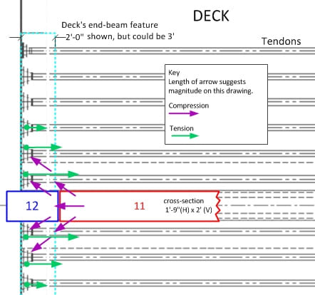

The ongoing discussion leads me and some other posters above to wonder how the design intends to route stress from #11 to the deck's tendons. For orientation, we're discussing this area:
A naive first speculation might be like the picture (plan view) below, which troubles the mind because of its poor distribution of forces to the tendons. (I think SheerForceEng remarked on this):

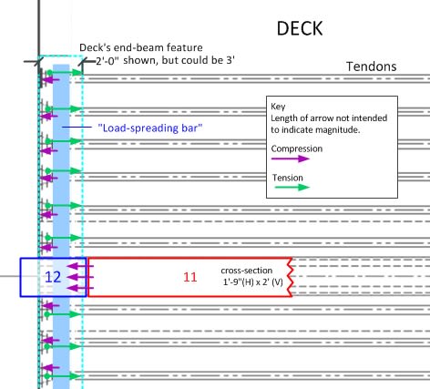

So perhaps the idea is like in the following image: #11 presses on the deck end beam, which in turn acts as (or contains) a very stiff bar distributing the horizontal load to the tendons. Is that feasible?

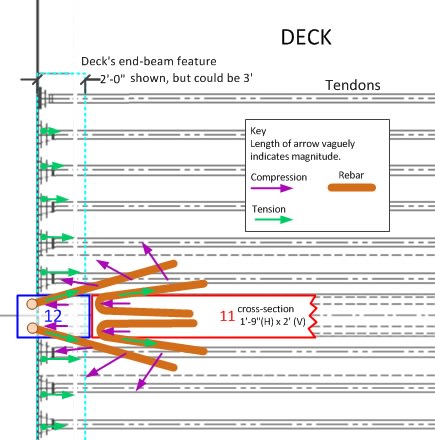

Or might the horizontal load from #11 be constrained by rebar that folds back south (rightward) into the deck for some distance: Either rebar in #11 folding like a hairpin under #11 into the deck, or L-shape rebar, with one leg vertical in #12, and a horizontal leg into the deck. Those horizontal legs in the deck could be long enough to spread compression broadly into the deck, to be resisted by the tendons?
Might this last scheme, if a valid approach, correspond to the rebar seen at the left of the NTSB "rubble" photo earlier on this page, apparently torn out of #12?
Great schematics!
If shear failure at the ends of the structure was the cause, it seems that an approach more towards a solid web of the I-beam by both ends could have added some safety factor with little penalty regarding materials, weight and "aesthetics".
For example, another horizontal beam resting on the lower deck, with horizontal PT elements running between the low portion of the two last diagonal members of the web.
In other words, forming a self-supported triangle that liberates the end of the lower deck from additional tension and shear loads, as well as those diagonal members and their nodes from bending loads (element 10-horizontal beam-element 11 and element 2-horizontal beam-element 3 triangles).

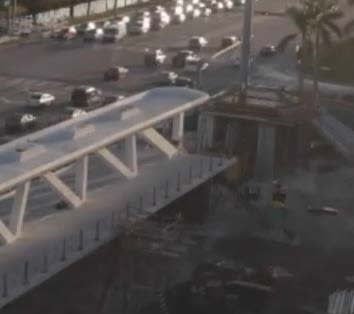

Regarding the protrusion at the left end of the deck, shown in the time-lapse video right before the failure initiated, I think gwideman is correct, it is just the deck corner coming into view as the position of the camera continually changes position.
We know that lower PT bar in member 11 crossed the failure plane at the end of the deck because its anchorage remained in the deck section after the collapse, causing the bar to be ripped out of member 11 as it fell. This supports the theory that the horizontal failure plane was located somewhere near to that shown in gwideman's sketch.
It also appears that the deck section remained nearly intact after the collapse. This seems to imply that the longitudinal post-tensioning in the deck did not adequately participate in transferring the compression in member 11 to the deck.
The failure resembles a punching shear failure in a pile supported footing with no pile under the column, only in this case the column was at the edge of the footing. The only benefit of member 12, and the future pylon, in resisting shear failure, other than a bit of confining compression pressure on the joint, is that they necessitated the need for vertical mild reinforcement through the failure plane. But the contribution of this steel would be minimal until the bridge was completed.
It is unfortunate that a longitudinal PT strand was not positioned to run down the middle of the deck as this would have directly resisted the punching shear of number 11 transferring the load directly to the deck by confining the end of the girder with a PT anchorage plate. The location of the 8" deck drain may have prevented this...an unfortunate tail wagging the dog effect. This drain pipe also seems to have dictated the temporary bearing locations on top of the pier preventing a reaction point directly under member 11.
