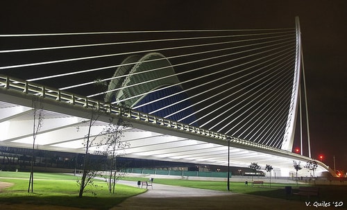

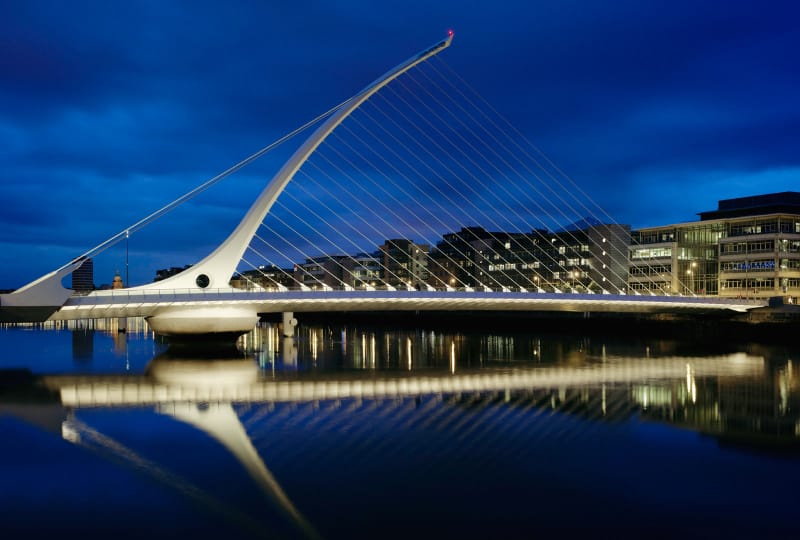

RE: Miami Pedestrian Bridge, Part III
Quote (drawoh)
Okay, I am mechanical, not civil or structural. If management is determined to make it cool, ask for a budget. Maybe you will get a big one! I perceive rule 2 as an artistic issue, but maybe there is a structural component too.
Like this ones:
