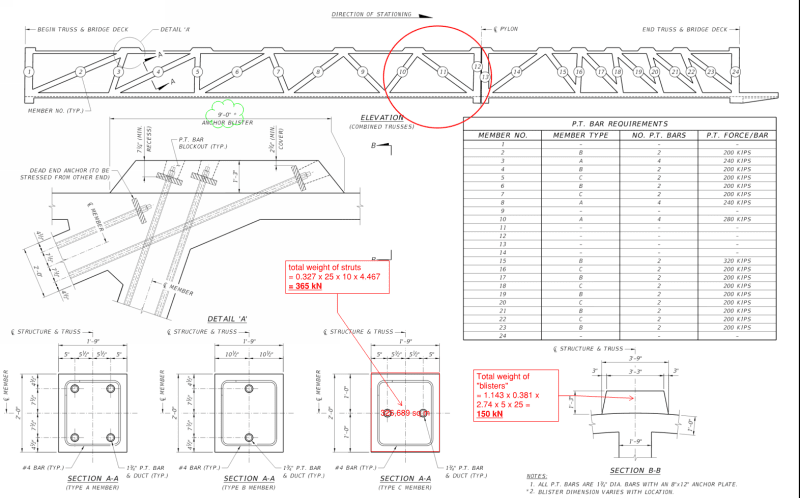

The design drawing shows the walkway has been post-tension both longitudinally with 12 PT ducts and transversely with PT at 2' 6" centers. That explains it is still in one piece lying on the ground.
Thus the joint of member 11 has broken from the walkway which is 31ft wide acting as the bottom chord for a truss of only approximately 2ft wide. The first question to any designer is how much width of the walkway can successfully interact effectively with the middle truss. There are guidance in the codes for that.
Some serious reinforcement would be required to dissipate the force in the member 11 into the bottom and top chords of the truss?
The broken concrete of member 11 in the photos show only a few small diameter bars.

The broken-off end of Member 11 has rebar I estimate mostly small diameters like 5/8" to 3/4" and does contain any transverse PT duct or tendon. The densely spaced 67 number of transverse PT casing has a concrete cover of 3.75". This could suggest the Member 11 could have shear off outward to the North with a layer of maximum 3.75" of the top concrete from the walkway. The downstand beam here is also only 2'10.5" wide. The south side, with a 3'6" downstand beam did not collapse and still have the canopy and walkway separated by middle truss after the collapse.
There is no code to help a designer on how much steel reinforcement to put in to dissipate the stress. It is down to experience and to realize the design assumption that the joints are rigid enough. When the reinforcement drawings are available a more definitive assessment could then be made.
The evidence so far points to the Member 11 wasn't adequately reinforced/connected to the 2'10.5" wide downstand beam and the walkway. May be the embedded longitudinal PT anchors were in the way but the designer must have a scheme to pass the axial tension (occurred during swingin-in) and then compression (in service) into the walkway because the truss system lies in the middle empty 3'1" corridor where there is no longitudinal PT system.

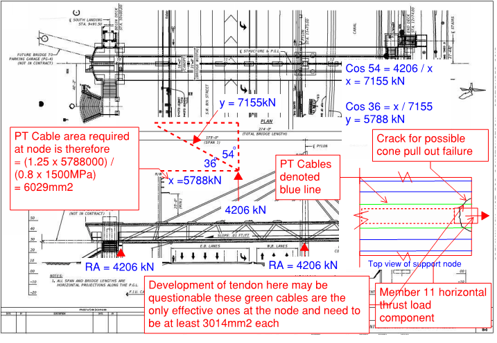

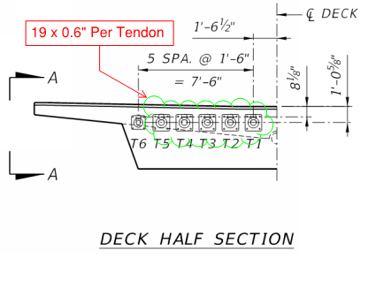

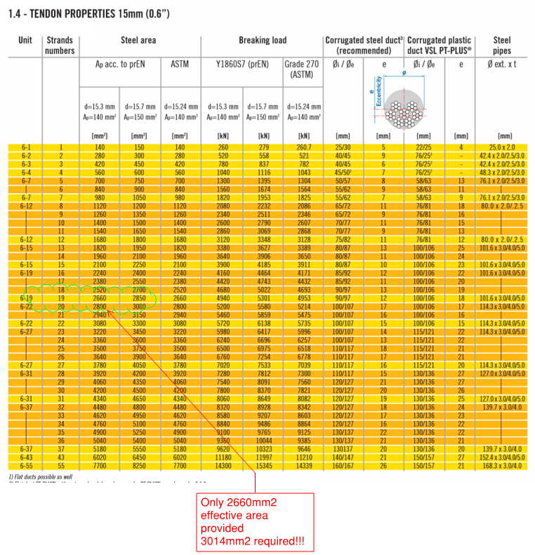

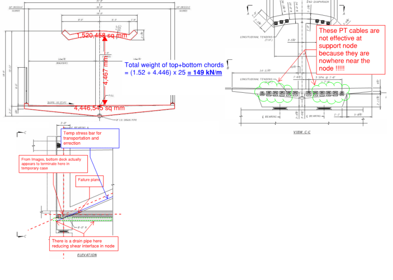

Does anybody know what tendons were specified for the bottom chord of the truss? They are type 5 specified on the drawings (meaning each cable is 13mm dia.) however it doesnt specify how many cables per tendon there are.
** Edit, I have updated the check below to show the 0.6" x 19 cables per tendon which was found in earlier thread and brought to my attention by username Ingenuity this is numerical proof now of where the failure is and why it failed**
***Case Closed***
gwideman - what is happening between 1:24 and 1:25? I thought that could be the deck pour but I also am not really sure what I'm looking at.
Sorry, not sure if I was clear on my previous post, my hypothesis is as follows:
- Insufficient development of bottom chord reinforcement at the node of member 11 and 12 junction.
- This is further made worse by the drain pipe punching through this junction as well as grout ducts/tubes either side of member 12 at this node. This reduces the shear plane area and makes it harder to engage the PT tendons that are quite some distance away from the node itself.
- The node detail is made even worse by the fact that the end face of the bottom deck doesn’t actually continue all the way to the outside face of member 12, making development of the PT cables where it is required even more problematic. This means we are engaging very few of the cables in reality at the node.
I’ve completed a few rough hand calculations to verify the loading and forces we are dealing with. I am old school and believe that we don’t need FEA or fancy analysis to solve such a simple determinate system.

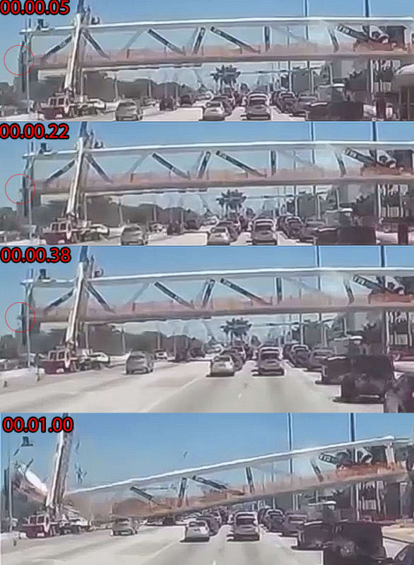

Timed the collapse, took a little under half a second from the first suspicious event before the structure visibly bends. The first frame is where I was able to pick up a batch of pixels that resembled the concrete protruding from the bridge. The debris seems to blow out at least 5-6 feet at the 1/3 second mark before the bridge comes down.
Yes, the PT has been summarized in previous parts. See thread815-436595 and go to post with time:date stamp of 17 Mar 18 07:27
ingenuity said:
Yes, the PT has been summarized in previous parts. See thread815-436595: Miami Pedestrian Bridge, Part I and go to post with time:date stamp of 17 Mar 18 07:27
Thanks for this, I have updated above, it shows it pretty conclusively now.
I have used some data from this forum as well to help with the numbers so thanks to everyone for contributing.

And in the 4 screen grabs by INCENTIVE immediately above, member 12 looks to remain in the vertical position for the first 3, well after the postulated debris is blown out of the end.
And in one of the earliest posted videos by Tomfh in Thread I, 18 Mar 2:42, member 12 actually looks, of all things, to be pulled inwards. Of course its final resting place is on top of the pier, so 11 would have to push it out in the final moments.

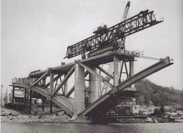

Previous posts in PART I, II and III of this subject have asked about previous prestressed concrete truss bridges.
I was recently browsing through a book "200 Years of Concrete In Australia" and came across this construction photo of the RIP Bridge (no it is not an acronym of R.I.P). It is a prestressed concrete truss, located on the waters of Woy Woy, about 100 km north of Sydney. Constructed in 1974. Main center span of 183 m (600 ft) and a total length of 330 m (1080 ft):
If I recall correctly, it "suffers" from excessive upward deflections at the center. During the period of when free cantilever bridge construction was in its infancy, several bridges experienced excessive creep deflection, with noticeable mid span sag (downwards displacement), so additional prestress was applied to avoid any sag - unfortunately too much prestress was applied to the RIP Bridge, and 'creep' - acting opposite to gravity effects - caused its midspan 'hump'.

***Case Closed***
We will inform the NTSB. They will send you a check. US$ okay? :-) Aussie sarcasm - dies hard!
SheerForceEng
As I pointed out in Part II shear lag is a definite design consideration in this structure particularly at each end. The ducts in the deck are plastic even though I feel they should be metal to make the bond more secure for the grouted strands; there is no lateral distribution reinforcing of any consequence near the strand terminations and the lateral deck tendons are at 2'-6" oc. If your theory is correct then the structure should have failed at the opposite end where member 2 is at an even flatter slope. Are there fewer service ducts and post tensioning ducts at the other end reducing the effective bond and local area of concrete.
Not sure but lateral distribution of loads from the web to the flanges is definitely an issue and could be a factor in the failure. As per Ingenuity I would not cash the cheque yet, case to me is still open.

(Dashcam frame-by-frame)
Off the left end I see a few pixels of something. More conspicuously, I see a more solid object progressively protruding to the left at deck level, which it's tempting to see as 11-12 pushing out to the left, maximum at 00.00.38. However, it could also just be that "protrusion" is really just the north-west corner of the deck and changing perspective as the vehicle and camera move toward the bridge. Someone on an earlier part of this thread discussed this too, I don't recall the conclusion. Unfortunately that area is behind what I believe is a cherry picker arm, so difficult to see the continuous visual lines of the deck.
