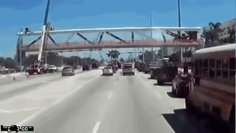

I made a gif of 11 frames and cleaned it up a bit. Let's see if it loads.
Well okay & the 10MB is in the attachments. I cleaned it up as best I can. After looking at the failure to the top left of #11 and to the bottom left of 10 & 9, I wonder if the position of the drains & the recess under the bridge for the drain pipe didn't create a point of weakness. Link
Tomfh...great video w the dash cam...i see an explosion at the bottom of the vertical at the support...maybe the strand they were pulling at the top of #11 came out at the bearing node of the truss...the tension diagonal adjacent to #11 appears to punch thru at the bottom as well
Tomfh your cleaned up video is great! You should give copy to each party concerned. It looks like tensioning of the truss going down t the left pulled the top and the adjacent truss going down to the right and thus breaking the walkway then the top chord also broke.
Better yet secure copyright to the video and sell it to the parties. Delete your post here.

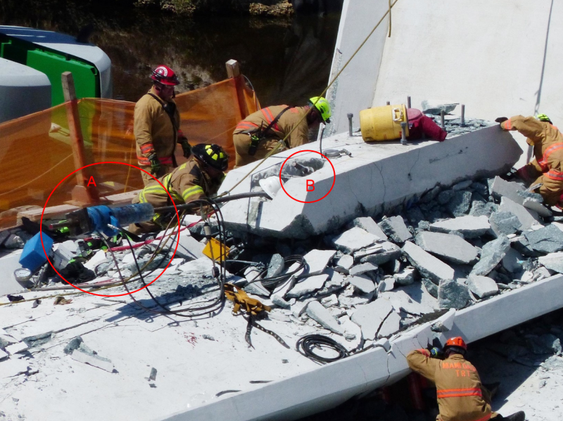

BA, yes, definitely can't have a truss without a tension chord. Look at the zoomed in video posted by Tomfh up thread a little bit. It is very fuzzy, but in the second frame, it looks like you can make out something shooting up vertically from the top chord first panel point and in the same frame there appears to be an "explosion" of dust at opposite end of diagonal #11 at the bottom chord bearing end bearing. What we see in this frame could be the result of the PT rod rupturing under tension and erupting out both the top and bottom ends of diagonal #11. The object that appears to shoot up in the air from the top chord would be the stressing ram still attached to the live end of the PT rod. The dust cloud at the bottom of the diagonal would be the dead end anchor plate erupting out of the concrete. What do you think?
gte447f, sounds plausible. Perhaps the stressing ram is the mysterious "blue box" reported in the Wikipedia article.
BA
From this reddit post someone spotted two tendons in the PT Blister and if the mysterious "Blue Box" was the the control box in the same picture and it dropped, well..., that would have been very bad. Link
I'm skeptical of the "reports" of a blue box being dropped from the crane onto the canopy/top chord just prior to the collapse. Some of the same reports mention the blue box hanging from a blue cable. Who has ever seen a blue cable? Some of the same reports that mention the blue box falling from a blue cable quote congressmen as saying things like, and I am paraphrasing here, "they were conducting a stress test... they were impacting the bridge with a load to see what it could handle", implying they were intentionally dropping a load onto the deck to see if it could handle the impact. Of course that is absurd. Even Marco Rubio has made statements about the "cables that suspend the Miami bridge", when of course we know there are no suspension cables involved. So, there is a lot of uninformed information out there.
Now there was a crane there, and you do wonder why. What was its roll during the tensioning/detensioning operation that was going on? Could something have fallen from the crane? I suppose so, but why would something fall from the crane, and what would be large enough to contribute to the bridge collapse? What are the chances of 2 catastrophic failures (the crane and the bridge) happening at the same time, or I suppose one catastrophic failure resulting an an immediate second catastrophic failure?
Of the two blue things in the photos of the collapsed bridge, one (the cylinder) is the stressing ram/jack and is still attached to the PT rod which has clearly erupted from the diagonal about 5 or 6 feet, and the other (the box) I think is the hydraulic gage to monitor the jacking force. I think this gage would have been on the deck right next to the workers stressing the pt rod, not suspended from a crane.
Thinking out loud, all of the stressing equipment (hydraulic ram/gauge/pump) is heavy to lug around, and likely would have been hoisted up top with the crane instead of manhandling it up there. You can see maybe a lifting line and a red tether in the photo above that may still be attached to some of the equipment (I can't tell). Or, could it have been fall protection for the workers?
