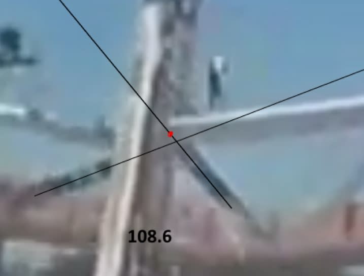

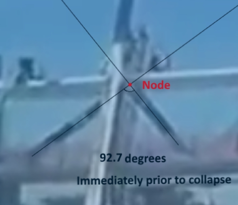

The video would suggest that we are focusing on the wrong member, 11. The collapse occurred at the top and bottom of member 10. And if others are correct, member 9 which intersected with 10 at the bottom, had no prestress. But wherever the failure actually occurred, the issue here is joints in a concrete truss/frame. In these forums, we often discuss problems to do with efficiency of concrete joints, and it is widely known that they can't be 100% efficient, but I don't know of any literature about design of concrete trusses per se.
The video that p205 posted was probably the best of the failure. Is there software that can show the individual frames and maybe enhance the image. The event happens so quickly I cannot determine if the failure started at the top of the diagonal member or at the base. The web member did not appear to buckle and it appeared that the panel point may have failed.
Dik
Here's a couple of frames from the vid. First frame is immediately before collapse. You can see #11 intersects with the node.
Following from that, something has happened to #11, and it no longer aligns with the node. Pity that crane is in the way.
Here's the relevant frames from the CCTV. Not a great video, however it appears something's happened to #11.
