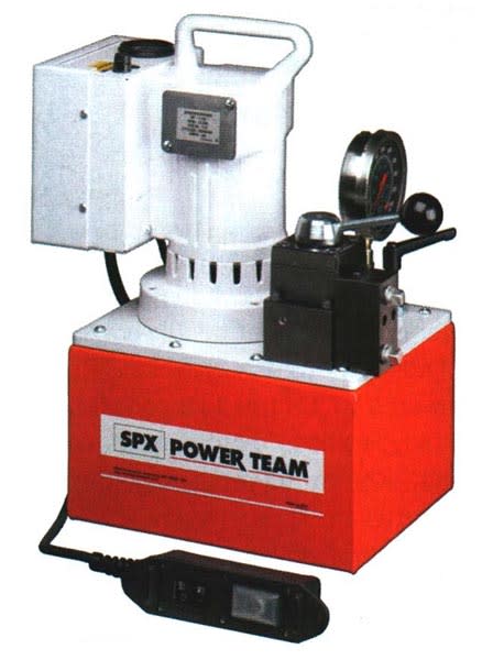

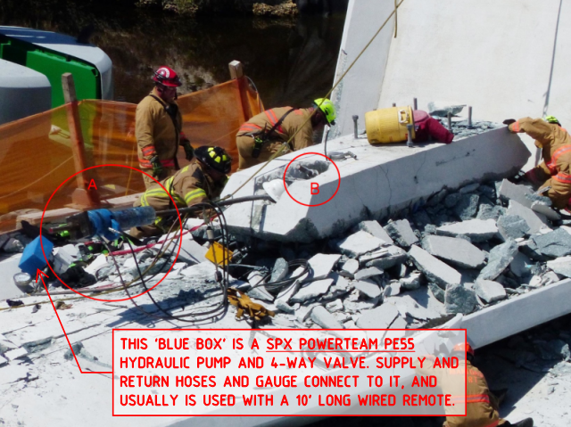

gte447f - I have been skeptical of witness statements as well because they are often unreliable. There are actually 3 blue objects. The ram, the metering/pressure rig (control box) and the hydraulic fluid reservoir. With the arched canopy, the thought to sling the control box from the crane might have seemed like a good idea at the time. If indeed, this was the case, then the investigators probably already know that, when the control box fell and uncontrolled pressure surge to the jacking ram overloaded the tendon. Full Size Photo: Link
Original 'Powerteam' orange that was re-painted in VSL 'blue':
Full of oil, these pumps weight about 65 lb.
Stressing is always a two-person (minimum) operation: pump operator and jack 'stressor'. If you look at the videos that Tomfh and epoxybot post you can see a guy fall as his lanyard tie-off breaks, so likely that the pump and operator were in a 'dog box' suspended from the crane.
If the "pipe stays" were indeed almost cosmetic, then it bothers me a lot that all of the diagonals of the truss were aligned with the stays, instead of given simpler geometry.
epoxybot said:
...metering/pressure rig (control box) and the hydraulic fluid reservoir.
I cannot see a 'third blue object'. And with a PE55 pump the 4-way control valve (for double-acting ram) and oil reservoir are all contained within the same box, as my photo above shows (the orange pump).

What I see in the two photos are a Blue ram & control box with what looks like a blue plastic reservoir (with rounded corners) and then in the other picture a scratched blue metal ?reservoir?. Perhaps in the photo with the A & B designations the reason the third item cant be seen is because it is behind the fireman. IDK.
