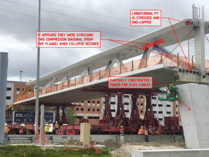

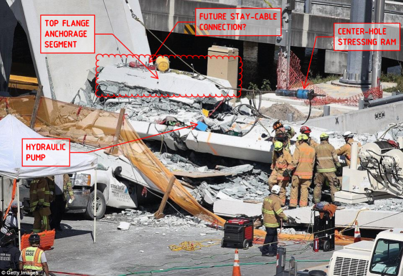

At the time of collapse it appears they were stressing PT bar/s to the first COMPRESSION diagonal from the top flange, at the first interior 'node' from the future stay-cable tower, as per the following photos:
Future stay-cable tower to the left of the photo:
Photo looking along the longitudinal-axis of the bridge:
General view during erection:
After they set the bridge in place, they de-stressed the two top deck tendons. Link
The column at the end of the bridge where the tower was to be built, was only half of its final width. Once the other half of the bridge was in place the two half columns were to be joined together & the column would have had an octagonal shape.

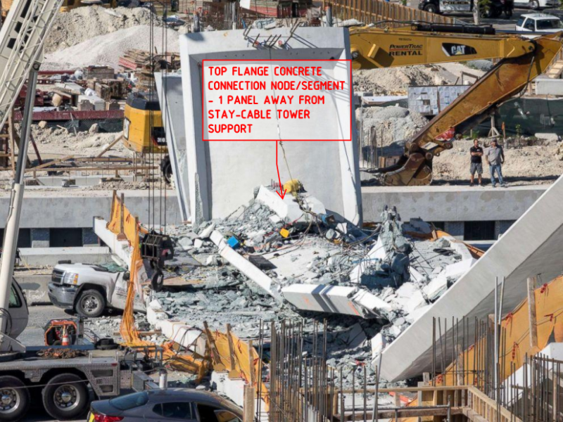

Here is an interesting angle Link
Couple other large scale reference photos
Link
Link

Why would they be stressing at that stage? The truss was spanning full length, and should have been complete, at least for that stage of construction.
Report mentioned above said that cables had loosened and were being retightened.

I don't understand the detensioning of the top deck PT.
Most of interest would be the details of the anchorages within the concrete elements. Were they castings?
An issue with a concrete truss is that it doesn't want to act only like a truss, but also like a rigid frame, so there are substantial moments at the joints. Central stressing would not cope well with these moments, so a lot of deformed bars would be required. Does anyone other than me think that the photos show very little in the way of non-prestressed reinforcement?

Ingenuity...great photos...and as Hokie66 mentioned...why would they be stressing that compression diagonal in the field? It looks like there is a single tendon running thru the center of that diagonal...Why wouldn't there be reinforcing around the perimeter of the compression diagonal to increase it's moment capacity?
I don't know how many times I've had to hear about the Hyatt Regency Failure in getting my Ethics hours...but (and I am assuming here) If there were problems with slipping of tendons...and concrete cracking observed and they were trying to re-stress a tendon...then the Traffic should have been shut down....but then there is the other side...the Pride of our design and the Fear of letting others know we made a mistake...
