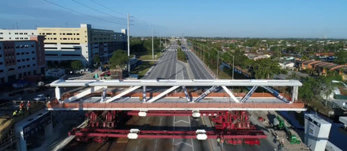

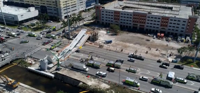

I am not a civil engineer, so bear with me as restate what is being discussed here, and what I have seen in reports, photos, videos and Google street view.
Here is the artist's rendering showing the cable supported pedestrian bridge.
Here is the main bridge span resting on two supports on either side of the highway. Notice NO cable supports.
The collapsed bridge shows no evidence of the tower. No tower = no cables. So, the span crosses 8 or 9 lanes of traffic with no supporting cables.
So maybe someone had built a temporary support from median strip to the bridge span? I'm looking through the pictures and video and seeing no evidence of any temporary support structure.
How could they have opened the road to traffic when the bridge had no cables? It's a cable supported bridge, for God's sake! And without any temporary support structure?
Am I missing something here?

Here is a good shot of the post-tensioning Link
Notice the VSL Corp truck/van under the bridge Link
If VSL isn't working on this bridge, then they will for sure get to the bottom of what went wrong.
Notice also in the last photo the tensioning equipment. I wonder if they were tensioning some strand when something went wrong?
hokie66 - I have looked at several pictures and it does appear to be a concrete truss with post-tensioned bottom slab/chord. The truss web arrangement would appear strange, but looking at the final design, the webs match the angles of the permanent cable supports. Still they're not symmetrical at all for this temporary construction condition. It's a long span with certainly a lot of dead load and high truss web member forces. It's not a typical truss web arrangement, and it's a concrete truss. That's a lot of unconventional items in one large design.
