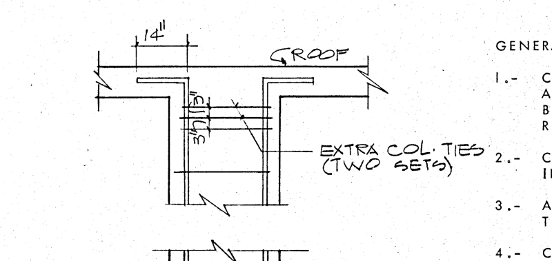

I see from pictures posted by Spartan5 back on July 5 that a typical column top poking through the pool deck seems to have been tied to the slab by 4 pieces of rebar embedded in the column, bent 90 degrees, and extending into the slab about a foot.
I haven't a clue how to read what the drawings say SHOULD be there. Is the above what the drawings call for?

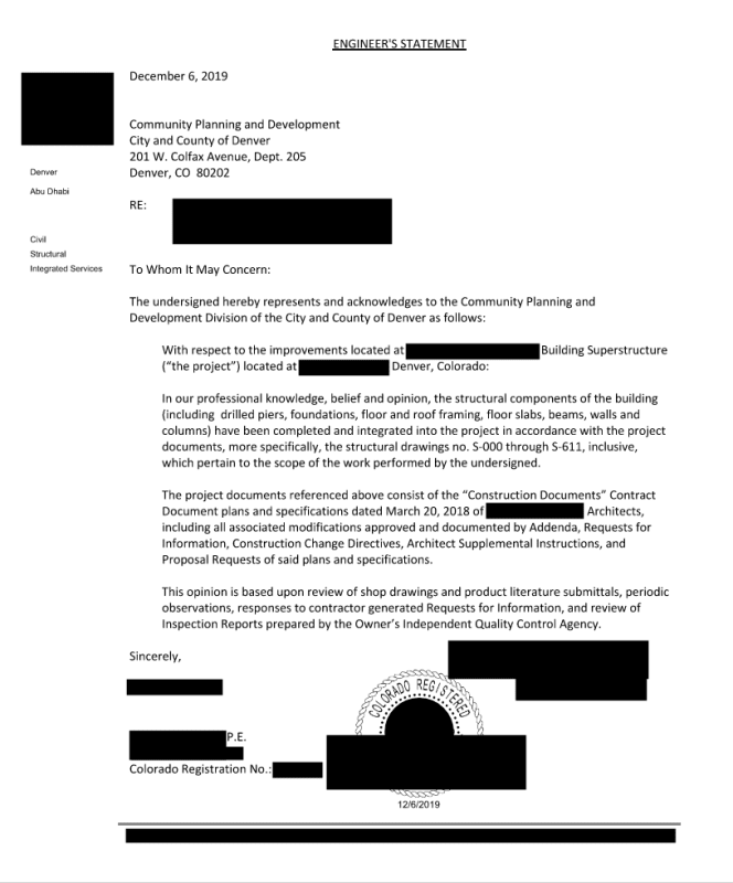

As far as final certifications by the EOR; in my experience, they will typically make a few trips to the site (or many if it's a long duration) to spot check things like rebar quantities and placement, final column dims, etc. At the end of the job they produce their as-builts and we get a letter from them stating something to the effect of 'to the best of my knowledge the structure built at 123 Mountain Lane Drive under City of Denver Permit Number XYZ123 has been constructed in conformance with the construction drawings captured by the approved permit'. That letter is always stamped.
That may just be a thing in my local jurisdiction, though, and it may not be a hard requirement. I'm not an EOR so I don't know the rules, but that's what's typical.
For reference, here's the letter from the last high-rise I worked on:

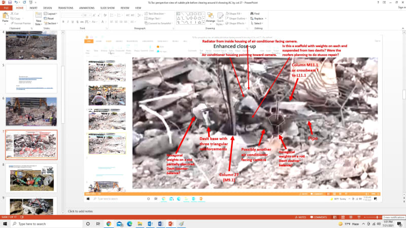

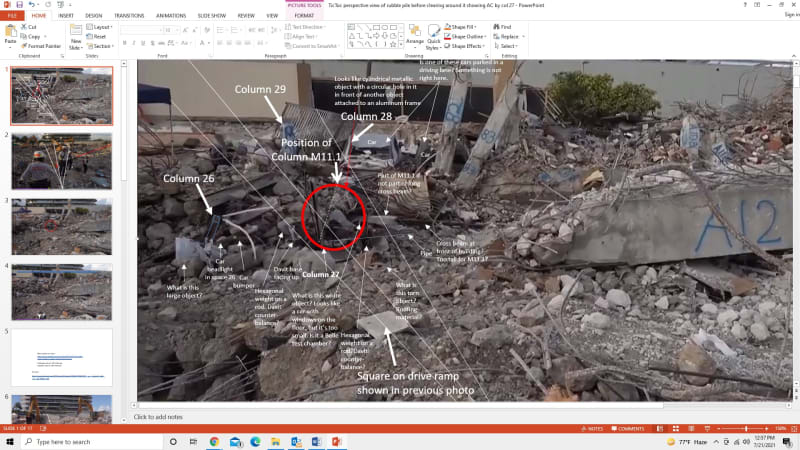

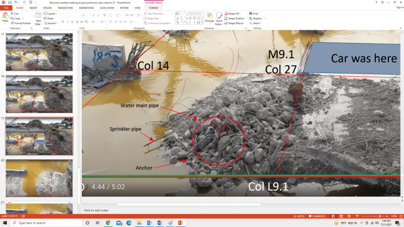

I thought it would be interesting to show some close-up photos of the debris pile that can be seen on a 1920x1280 pixel non-interlaced display while zooming in on frames snatched from high resolution still photos and videos taken by a drone which are then pasted into a PowerPoint document to enable using its powerful zoom capabilities.
The first photo below shows a close-up of the debris pile just before it was removed to clear the floor for foundation studies. The pile shows objects that were seen in the TicToc video and in the vicinity of column 27, but the objects have been pushed onto the pile from their original positions further away and then the whole pile has been pushed closer to the ramp, causing many of the objects to lie in the driving area at the foot of the ramp. Nevertheless, one can see that the recovery workers have used red spray paint to call attention to several objects of interest further down in the pile. One of these objects of interest that is easily distinguished in the photo is the sheet metal top of an air conditioning unit which lies close to the surface of the pile. One can assume that one of the other objects of interest identified by the recovery workers as lying further down in the pile is the lower part of the same air conditioning unit with the radiator, cooling fan, and refrigerator pump. By looking at multiple frames of the video taken as the drone flies past the pile, one can confirm the identification of the top object and a several additional objects nearby as well as seeing down into the pile to confirm that something of interest is below. But it is not possible to confirm the identity of the object below.
The second photo below shows these same objects as they were being uncovered by a back hoe at the bottom of the collapsed debris pile and before they were consolidated into their own little debris pile. Therefore, their locations in this photo are closer to where they naturally fell during the collapse. One can see that the objects in these locations correspond very closely to the objects seen the same locations in the TicToc video. One can easily see the location of columns 26, 27, M11.1, 28, and 29. One can also clearly see that there is a dark-colored car parked in parking space 26 next to column 26. One cannot see a second car in parking space 27 between that car and column 27. But we know from the TicToc video that one is there, and we can see two objects the fell on the hood of this second car; namely, a davit base and what appears to be a hexagonal weight on a rod. The davit base is easily distinguished from an Osha anchor by having no loop on top and by having three triangular reinforcements welded between the base and the central column. Interestingly, a second hexagonal weight can be found on the other side of the red circle. These objects raise the question of what other work was planned or in progress on the roof.
This photo also shows several objects inside the red circle. Closest to column 27 is what appears to be an air conditioner housing with the top opening facing the camera. The housing looks like it has a bulge on the right side similar to some air conditioning units that have a pump to the side of the radiator core. Behind it lies either a second air conditioning unit with the top facing the camera, or perhaps just the inside radiator core of the unit corresponding to the air conditioning housing in front. One can also see what appears to be either column M11.1 tilted to the right or the cross-beam between column M11.1 and L11.1 with its lower end near column M11.1. Either one could have been produced by the air conditioning unit falling between the car and column M11.1 to cause a wedge-like force, which would have caused a high lateral force on column M11.1 as well as a downward force caused by an object falling on the deck. This lateral force might have been what caused column M11.1 to buckle as seen in the TicToc video.
Also in the red circle at the bottom of the pile near the floor of the driving area next to column M11.1 one see a white object with what appears to be windows. But this object is too small for an automobile. While this object has not yet been identified, it has been found that a similar-looking object called a Belle chamber is used for testing roof surfaces for de-lamination caused by hurricane force winds. The chamber is used to apply a vacuum to a 5x5 foot area of the roof while one looks though the windows to observe how high the roofing material rises as a result of the vacuum. The size of this chamber appears to correspond to the size of the object shown in the red circle. Is it possible that such a chamber was being used or planned to be used to test the roof and left on the roof overnight at the time of the collapse? This needs to be further understood.
The objects in the second photo above can be discerned more clearly if one enhances the photo and zooms in further as shown in the photo below. In this enhanced photo one can more clearly see what appears to be a second air conditioning unit facing the camera at a lower position, which may have been the original object seen next to the broken column M11.1 in the TicToc video. Also seen more clearly are the two hexagonal objects that I believe may be weights, and a davit base. In this photo one can clearly see that the davit base is not an Osha anchor because one can clearly see the triangular reinforcements welded between the base and the central column. Finally, in this enhanced photo one can see traces of what appears to be a scaffold between the two hexagonal weights.
One can see that these photos have much higher resolution than a mere “potato camera”. They also have higher resolution than when viewing the same videos using a cell phone or an interlaced 640x480 pixel desktop display.
If one is still skeptical that air conditioning units cannot have fallen from the roof to be found at the very bottom of the debris pile because they are tied down so well by mechanical straps, electrical power lines, and refrigerant lines that they are secure in a hurricane, consider the following. Photo 4 below shows excerpts from the permit issued on the day of the collapse and from an HOA letter describing the work to be done on the roof. These documents show that not only were Osha anchors to be installed on the roof, but also other work was to be done at the same time including stucco repair, air conditioner replacement, and exhaust fan replacement. We also know that a satellite dish was being installed at the same time by an independent contractor. Given that air conditioning units were being replaced at the same time, it is highly likely that some air conditioning units on the roof were not attached at the time, either new ones waiting to be installed or old ones that had just been replaced. These unattached units may have been the ones that fell and were found at the bottom of the debris pile.
Those pictures are grainier than my BMs after I’ve eaten nothing but trail mix for a week.
You can’t even hardly make out the text you’ve written.
spsalso
Not sure it's what the drawing intended to call for, but yes, it calls for it. The pool deck is considered a roof. I cannot find any other details on this.

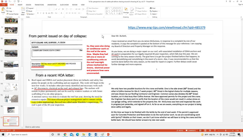

If I was the building owner, I sure would want stucco repair done before I replaced the whole roof? I would think they would install fall protection anchors, and they haul up Swing Stages to do wall repair, then do the re-roof. But this is Miami?
Scaffolding would be required for swing stages as tie down cables could not drape across the parapet wall on the way to the ground for anchor, nor could the parapet walls be considered strong enough to anchor too. And perhaps weights were hanging off side of building, to counter balance the swing stage?

The man behind the BecauseSurfside channel would be the man to ask about that.
The roofing equipment I posted earlier, is rumoured to have been seen left on top of the building overnight. The hot tank trailer as well. It's not unlikely other stuff was left up top either.
Speculation, no facts.

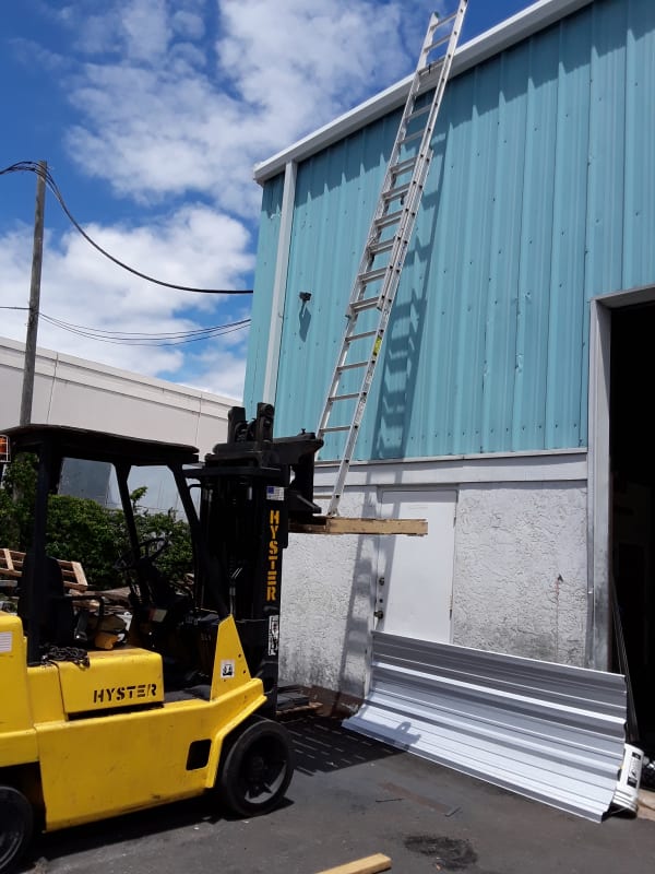

Uploading pics to Imgur and then linking makes them a bit clearer, maybe try that..
This platform is rather archaic, have the site Over-Lords considered upgrading? I would imagine with the recent state of affairs of beachfront condos and hotels, this site will get a lot more popular.
@Demented, Who needs a 40 foot ladder, when they have a fork lift!

When you say "hot tank trailer", is that what I was calling a "tar kettle"? You showed a pic of one that looked ashy and burned, then I added a pic of a black one beside 2 crushed cars. Are these 2 different objects?
Link
Link
Yes, the tar kettle. There were multiples on the job site is all I know. Having not seen the stuff on the roof myself, I can't be certain if those were the ones he has been referring to, or the smaller ones we know were on the roof. The location of the maintenance spot and the image you posted to me makes a ton of sense. The ash may just be dust that has stuck to the side between moving, rain, being hosed off, etc.
What I find odd is, why would a crew leave the tar kettle on ground level overnight? That is a 100% sure fire way to get it stolen, especially in Miami.
It is impossible for me to make a single reasonably informed deduction based on what is shown in MarkBoB2's rubble pile photos.
Literally and figuratively, I'm just not seeing it.
