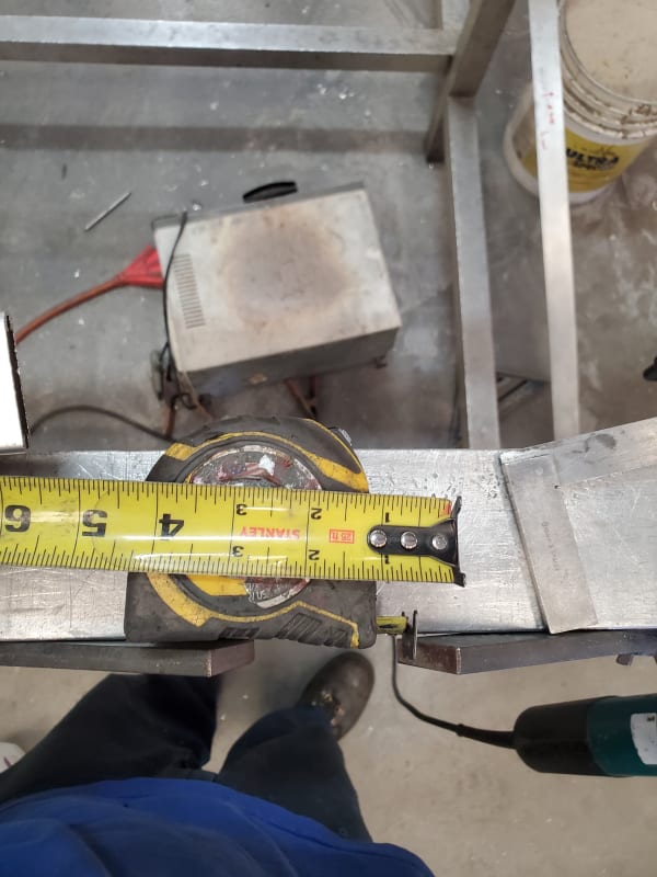

@Aapop,
Long by just enough for someone to have dropped a tape from the top of the form and forget a very important dimensions?
Unlikely, but not impossible.
