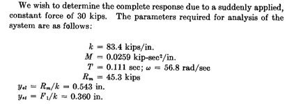

Since we would like to conduct sensitivity analysis, using the table is not very practical for the number of analysis we will conduct. Therefore we solved the problem analytically. However, the maximum response we obtained didn't match the table. So we took a step back and look at an example in the book itself:
Other parameters:
In this case the load has infinite duration. So we look at the table for a large value of td/T. In this case Rm/F1 is 1.5, which for a large value of td/T results in a ductility ratio of 2.0 from the Figure/Graph. However, as shown in the figure with the complete response of the system un the example in the book, the ductility ratio is 0.806/0.543, which is ~1.5. Using different values for td/T and Rm/F1 and solving the complete response analytically results in even bigger differences with the graph results.
I am wondering whether I am using the right parameters on this table or what is the reason for the difference between results?
