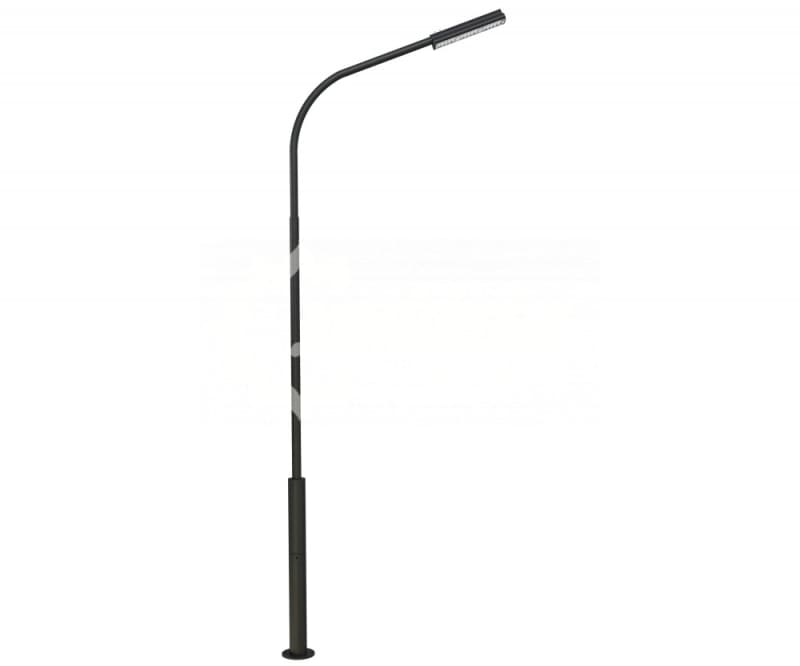

1. Pole like typical street lighting pole. (see photo below)
2. ME requirements - no welding, and U-beam should be used.

So you're replicating this nice looking picture, by slapping a light on the end of an arm ? IMHO, it does look pretty ugly, but I guess it does accomplish the goal. A fiberglass cover would look nicer, a socket fitting would look very tidy.
If the end of the arm is now open to the elements (and intended to be like your picture, closed) what to do about rain water ? Is the outside of the pole protected from corrosion ? Is the inside ??
