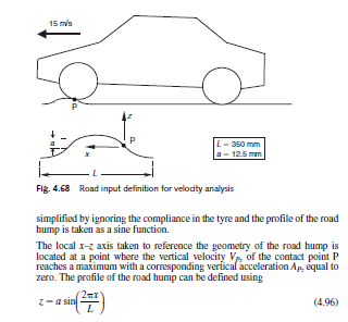

I got a problem in finding the result of velocity vs distance in my case study. In my case, the vehicle is travelling at constant velocity of 15m/s and go through a bump profile of z = a*sin(2*pi*x/L).
How should I going to define my input motion in ADAMS?
