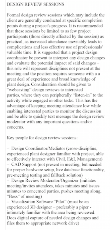

After reading Gator's various excerpts from the book lemurfromearth's post, it's pretty clear to me that SP3D is really for large company's with large projects. I suspect that many companies vastly underestimate the technical expertise required to implement and maintain SP3D. Case in point. I noticed in the matrix above that structural detail drawings is checked for SP3D yet my company decided it couldn't be done and bought a very expensive steel detailing program to supplement SP3D. Could it really not be done or was it just too complicated to figure out?
