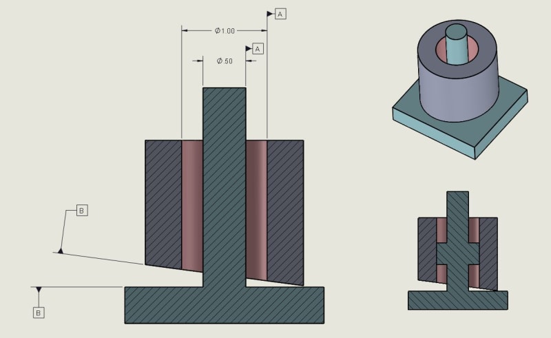

Is a MMB callout on the datum of a feature control frame for perpendicularity of a plane illegal?
Ev-36XPro
Oct 9, 2018
6
(Per ASME Y14.5-2009)
I just ran into an old drawing which has what I have now learned is datum shift. This concept is quite new to me, but I have become the person to settle an argument of if the usage of it in a drawing is illegal or not (simple example below). The first picture is the drawing as is. One person is saying the use of MMB on Datum A for the perpendicularity requirement is illegal because you cannot have datum shift on a surface. I see where he is coming from because it does not make sense for a functional gauge (although this part is only inspected with a CMM). However our inspection team raised the point shown in the second drawing, which is would it be correct if you added the FCF to Datum A, referenced off of B. And would that result in the same part? So are both illegal, one, or neither?
Also is MMB used on the datum legally for the dowel pin? I believe so because both are axis and it makes the most sense for a functional gauge.
What the drawing actually is.
Inspection team's suggestion.
I also included this because it helped me better understand datum shift.
Thanks everyone! [glasses]

Now let me take a stab on it:
perpendicularity of the cylindrical surface to B primary looks legit to me. A
Perpendicularity of the planar surface to A(M) looks also okay.
You just have to decided for the function of the product which is primary and which is secondary.
Don't let the tail wag the dog, meaning the inspection to drive the product definition.
Decide what you need for the function and then make the gage from there.
A(M) is the datum shift. B(M) is illegal.
On the first drawing B secondary in the position callout does not bring any value. Might be there for simultaneous requirement, but as a stand alone callout B does nothing.
Thanks for the reply greenimi. It is indeed ASME, specfically ASME Y14.5-2009.
To give some background on the design intent, this is a stator which mates with a rotor. The most critical dimension is having sufficient clearance or "air gap" between the rotor and stator. The rotor is attached to a gearbox which Surface B mates to. If B is not perfectly perpendicular to A, then we lose clearance. However, if the internal diameter of A is near the higher tolerance range, then the design can tolerance B being less perpendicular to A.
For the first drawing, is the FCF on surface B executing this design intent and providing "bonus tolerance"? (I know it's actually datum shift [bowleft] but just for design purposes it makes more sense to me to think of it as bonus tolerance [hammer] Ahhhh! Alright, it's datum shift!)
Thanks again for your help.
Your FCF is certainly allowing datum shift of your primary datum A. In your case (and others) it will deceptively "look" like bonus tolerance, but as you clearly know datum shift is NEVER actually considered a bonus tolerance.
See the discussion in the thread ( I always link to this when the question comes up because its what helped really solidify my understanding of what datum shift is and isn't and hopefully its helpful to others. I have also attached the graphic that CH developed (all credit goes to him for it - from the same discussion, post on 17 May 18 14:59) that was really instrumental in my understanding as well.
From that discussion arose what I found a useful way to think about it - what datum shift does is actually loosen the relationship between the datum feature and its datum feature simulator. The relationship of the allowable tolerance zones of the other controlled features on the part back to the datum feature simulator does not change. I also developed the below graphic to illustrate this point, and further show why in CH's second example with two holes on either side of the central datum feature it does not act like a bonus tolerance (I utilized the same basic dimensions as the original example).

Ev,
For the case of A at MMB, As the actual bore is produced larger in size you will have more amount of available play during fitting datum feature A over a gage shaft. This play may assist you to force an orientation of the part so that the entire datum feature B face can be fitted into an exactly .001 wide tolerance zone perfectly perpendicular to the gage shaft. This allows a face B produced with larger perpendicularity error to pass the inspection. Note that even though this concept allows you to accept features with larger error, this really isn't a bonus tolerance. Bonus tolerance is related to MMC/LMC and what it does is allowing the tolerance zone to enlarge under certain circumstances. In your case the tolerance does not enlarge - it is fixed at .001 exactly - but the additional play at the interface between datum feature A and its' simulator allowed by MMB allows you to fit a less perpendicular feature B within that same tolerance zone. Now it is up to you to decide if this is scheme is adequate for your part functionally or not.

In case Ev-36Xpro will want to know:
There is a difference between |A(M)| and |A(M)|B| in the feature control frame for the pin. For |A(M)| the full gap between the produced bore A and the gage shaft can be utilized for play (rotating the part until further rotation is constrained by the contact between the bore and the gage shaft). In the case of |A(M)|B| - B as a secondary planar datum feature will need to contact its' datum feature simulator at two contact points, and might limit some of the play in orientation that is available in the first case. Therefore there is more available mobility in the gauging process for the case of |A(M)| - and the consequence of that is that this mobility can be utilized to find an orientation of the part in the fixture that will allow fitting the pin within a gage hole representing its' maximum material virtual condition, and accept the part, which might have been rejected in case of |A(M)|B|.
Side note - according to the rules in Y14.5 regarding degrees of freedom constraints, datum feature and datum feature simulator A should constrain (edit: alone) the same rotational degrees of freedom that B secondary may influence in the scenario described above. In practice, the process would conform to those rules only if A was specified RMB. With A specified MMB, the physical behavior during gaging would be different, as the secondary datum feature might override datum precedence by constraining degrees of freedom that A constrains only partially. Nevertheless, since this scheme is shown in a figure in the standard, it is legitimate (edit: although probably should mostly be avoided).
After re-reading the described design intent in Ev-36Xpro post from 26 Apr 19 14:52, I suggest considering:
* B as the primary datum feature.
* Qualifying datum feature A with position perpendicularity MMC referencing B - as suggested in the second drawing in the OP.
* Controlling the dowel pin for position MMC referencing B primary and A at MMB secondary.
Edit: Another suggestion - not along the lines of the OP but perhaps even more appropriate functionally: since the bore designated as datum feature A is not supposed to mate by contact with the stator but should maintain clearance with it, It shouldn't be datum feature. If there is a pattern of dowel pins that connects datum feature B to the corresponding face of the gearbox, this pattern should be the secondary datum feature, datum feature B the primary - and the bore controlled for position referencing those datum features.
For this comment, I think I'm following and understand how the datum shift impacts the inspected parts. But could some comment if the exact same range of parts would pass inspection of the callout was flipped per my original post? So the FCF would be moved to Datum A and say: |perpendicularity| .001 (M)|B|
This type of FCF clearly gives bonus tolerance, but if someone asked me to build a functional gauge I believe they would look identical. Any thoughts on this would be greatly appreciated and a big thanks to everyone's valuable input so far!
