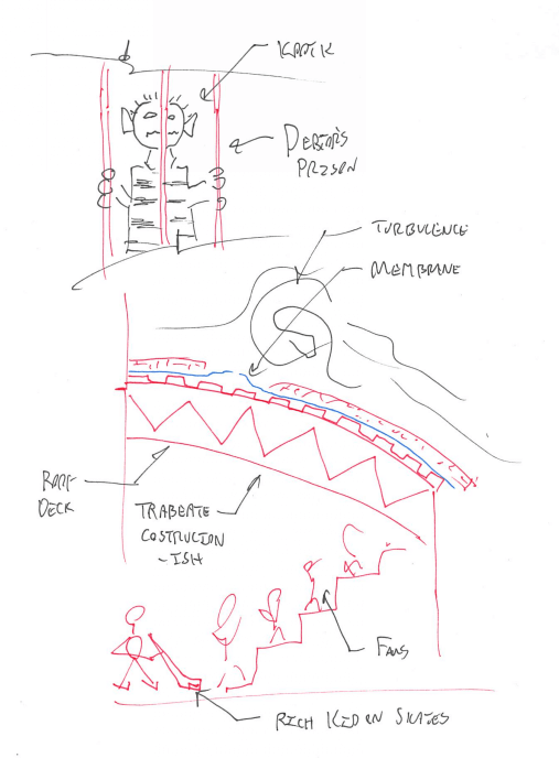

So I have a client with an interesting project. They're going to replace the roofing on an entire, domed stadium. Like an NHL stadium, non-retractable. I'm going to help by working out the wind loads on the new membrane. I'd like recommendations on fee considering:

Well... it's a stadium so it may well be a bit different. I ended up going $2500. That, because:
1) I still work out prices considering liability at times. Frankly, that relationship exists, for me, because I say it does. If the roofing flies off of an NHL stadium and I get sued out of existence, I'd not be looking back too fondly on a $350 fee.
2) This is something that I want to do carefully and double check a few times. I'll probably run it through some non-Canadian codes and take a careful look at how uplift on the membrane may or may not be different from uplift on the roof plenum as a whole (what we usually look at).

On the cheeky side, I'm pretty sure dome uplifts are smaller than conventional peaked roofs. Could you spend an hour proving that to yourself and then, since the Canadian code doesn't have figures for domes, calculate a conservative uplift force using the available figures and use that? Built in conservatism that gives you likely still conventionally constructable numbers with a 'best effort at using code' justification!
I could. In addition, I'd planned to run this thing through some of the international codes that tackle domes more explicitly. I offered up $1,500 but my client went ahead and put me down for $2,500 anyhow. They're great. Anyhow, there's plenty of fee room for me to do an excellent, peer reviewed job of this.
I'm not sure your typical roof uplift calculation applies to the membrane. Roof uplift is driven by a pressure differential between interior and exterior - in this case the "interior" is the space between the membrane and whatever comes next in the roof assembly.
Me neither and that will be a real part of my learning process. If anybody has a definitive answer on how one calculates membrane uplift, I would welcome input on that.
While I've not sorted this out for myself yet, I'm not so sure that I agree with you on this. Unless one can prevent interior air pressure from making it's way to the membrane, I would tend to think that it would be something similar to the differential between interior and exterior. After all, the membrane usually is the air barrier "thing", right? Perhaps one needs to modify the usual procedure to account for lag in equalization between the interior volume and the underside of the membrane?
