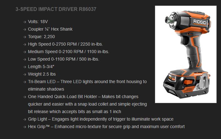

Alternately, is selling at HD for free with the purchase of the two batteries for $99, AND it claims 2000 in-lb torque.

Yeah we may have to explore something like that Ryobi or other similar ones. The handle shape isn't ideal for picking up the entire power unit like we want to do. Would prefer a D-handle shape for that. But we may have to compromise on that.

What about this?
shows the impact of variable speed, but if you want around 2500 rpm seems ideal?
