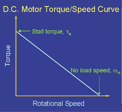

Keith, first, thanks for your detailed and orderly post, and for taking the time to do that. I appreciate it. If I may, can I ask why you think the stalled torque determination is useless? As I understand from researching performance of DC motors, if you know the no-load RPM, and you know the zero-speed stall torque, you can then calculate the RPM at any other torque. Or, you can calculate the torque at any other RPM.
Example:
If by testing or manufacturer's data, say you know the following to be true for a DC motor:
No-load RPM = 1500 RPM
Stall torque = 250 in-lb
If torque during operation = 50 in-lb, then speed has to be:
1500 RPM - (50 in-lb / 250 in-lb) * 1500 RPM = 1200 RPM
If speed during operation = 600 RPM, then torque has to be:
250 in-lb - (600 RPM / 1500 RPM) * 250 in-lb = 150 in-lb

That's not my understanding of how DC motors work. Torque is 0 at max RPM, and increases linearly to its maximum ("stall torque") at 0 RPM. As torque goes up, RPM goes down.
If you drive at constant voltage.

I agree with both EdSS and hydtools. Your theory is basically correct for a naked motor but there are too many unknowns for those end points to be useful. Starting with this being a brush-less DC motor which actually means it's a 3-phase AC motor with electronic commutation. I wouldn't trust those endpoints for calculating a door-stop. You want empirical data for your empirical application.

So what do you all think the actual motor curve looks like, if you don't think it's a line (or approximately a line) like I posted above?
