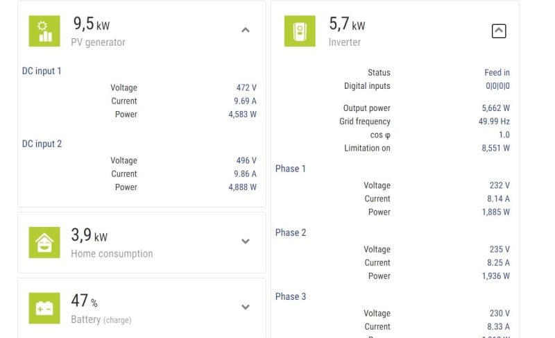

Just a note in the difference in philosophy's between areas and solar.
When I put my battery in last year I noticed that if it was charging it allowed the inverter to get full production off the panels. If it was already full it clipped the panel output to maintain the max output AC of the inverter to 8.5 kW.
Sent the German OEM an emial with the suggestion. Lady on service desk said we can't really help you... I said no problem just forward it to your tech director for consideration. Two days late received an email short and sweet "i like"
New firmware released and it has timed battery control for both charge and discharge (which was something else i mentioned to be able to restrict the use to Peak pricing levels)
So set it to release the battery for charging at 10:30am and it works perfectly no clipping.
Working with Germans can be a PIA but once you know what buttons to press and how its very productive.
