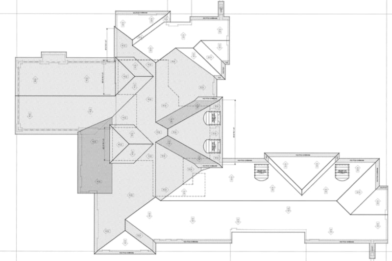

Designing a house with a complex roof. Such fun. Anyway, I am constantly arguing with myself over where we need load points at the connections of hips, valleys, and ridges.
I know a lot of it relies on whether or not you have exterior wall thrust. So if I have rafter ties and collar ties I consider the ridge a nailer. But what about when you have a valley and and hip coming in? They can have quite a bit of. Arrival reaction. I know good practice can be just to simply post down and feel good about it. I have seen thousands of times where the framer will just nail them all together with a few boards and it obviously holds fine.
What do you guys typically do?
I ask because I am going to a meeting with the truss company and the builder next week and he is going to want reactions where I have specified load points. If I give him true reactions calculated from my LvL calcs the loads will be astronomical. In some cases we land in walls but others on top of attic trusses where he will never get the reaction to work.
Show a framing plan where loads are astronomical. I have not found such a case, but I have not a lot of experience in residential framing.
A valley member will have vertical reactions that need to be resolved, and these reactions can be quite large. It’s just a function of the geometry of the roof and the load being collected at these points.
A hip, on the other hand, does not need discrete vertical supports as long as it is accompanied by thrust-restraining framing that is properly positioned and connected. I find that on complex residential roofs, because of the architectural concept of the space below, hips often need to be designed as vertically-supported beams given the absence of space below in which to provide reliable thrust resistance.
Also, If you rely upon membrane action of the plywood-sheathed roof to help resolve and distribute these reactions, you do so at your own significant risk. The chance that the system is properly designed and detailed to accommodate this complex behavior is slim (especially in light of fee and time constraints), and the likelihood that it actually gets built properly (even in the event that it was designed properly) is even slimmer.
Nowhere is an architect’s (or “custom home designer’s”) apparent disregard for (and/or misunderstanding of) structural load path more obvious than in an intentionally elaborate single-family residential roof volume. The costs they drive into the project with these features are staggering. And look, if that’s what the owner desires, then a good structural engineer is up to the task of resolving it. But there’s always a compromise needed. Some combination of space/depth and cost is always a concession.
If you need columns, you need columns. If the space below can’t accommodate a column, then you need a transfer element that can span between two point where columns CAN be accommodated. Stake your claim on what is needed structurally in order to resolve the architectural roof concept.

Do you have a general sketch of the roof?
Here is plan view of the roof. As you can see there’s a lot
Good lord... That is the most complicated roof I have ever seen.
I agree with Seppe and Eng16080's comments. Stick to your guns and try to keep your analysis and load paths simple at the onset for consulting with the truss supplier. Hopefully, they can stomach what you bring to the table at this stage.

For locations that don't have cathedral ceilings, often the trusses can clear span and essentially fake all this elaborate geometry. I'm guessing it's not that simple here though.

Haha yeah. Thanks guys. Maybe they will revisit using trusses when they get their LvL quote

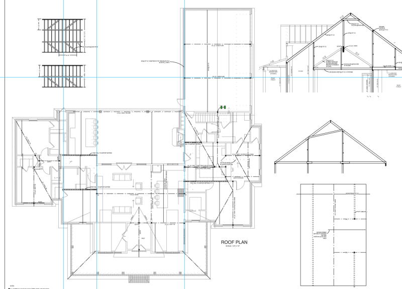

Here is one I am currently working on. Not quite the mess the OP's is. Was not too hard to find bearing. Just have to be creative. The roof pitch varies from 12:12 to 16:12 - gotta love these Arch's!
I did another one worse than this a few weeks ago. These roofs are such headaches. Not like with a beam you can just add some fluff and sleep better. What a nightmare.
I do roofs like these all the time and around here most things are stick built when an Arch and Eng are on the project. I tie the roof and use ridge boards where I can but anywhere that the tie breaks, I design a ridge beam. Also, I always design hips and valleys as structural beams supported on both ends. If the beam sizes are crazy or posts are large, I don't care as there is no solid engineering justification to ignore the thrust (outside of complex and sketchy diaphragm calcs). Obviously tons of roofs disregard all of this but as structural engineers I don't see how we can.
