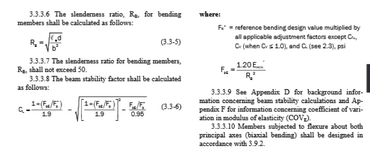

I think the point is that the source of this ponding load is not only the water, but also the stiffness of the joist. An infinitely stiff joist will have no ponding. Therefore, the stiffness becomes an input to the derivation of the load, which is life safety. So should that input to a life safety parameter carry the same statistical handicap (5th percentile) as other life safety parameters (reference bending stress, for instance), or should it be treated as "normal" deflection is treated, with average stiffness?
Emin affects the Fb* and Fc*
This is true, and though I agree with ChorasDen on the direct application here, I think it could give some insight. Where member stability is a factor in determining the strength of a member, we look to Emin as our stiffness. Ponding is a question of system stability impacting capacity - maybe Emin with a repetitive member factor would be the most appropriate method?
I understood what you were asking already.
Alright fine, for the curious..... I'll retract my previous "I was disappointed by it." But it's pretty abstruse, and there's even discussion in the commentary.
So that kind of follows with what Pham was going at.

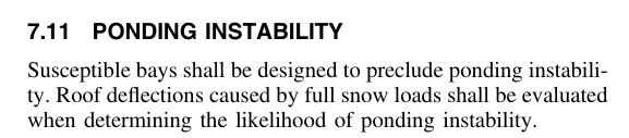

More to the point, though, is the OP mentions normally designing for snow loads and demonstrates a lack of familiarity with the design standard for ponding.
The concern I have with that is ponding is required for snow loads, too. So they should already be doing this for their northern state projects.
Source: ASCE 7-22
And for the compulsive, Chapter 7 is "snow loads"
