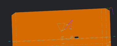

Hi all,
I have a newbie question. How do I hide the lables "line60", "arc3" etc. and the documents coordinate systems lable BUT keep the lines and the coordinate system. If I hide all sketches everything is hidden. This is in assembly environment and I'm using Siemens NX 1953.

How did you get these labels to appear ?
Try "F5" or right click in the graphics - Refresh.
this will erase if the labels are temporary graphics.
Else Menu - Visualization- View-Decorations -Show Object names= off
Thanks, turning off the object names did it!
I don't know how I got these lables in the first place, they were always there since I started my current job a few months back.
