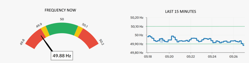

Yes, I am late. But Think that the discussion is quite interesting. If the grid is connected via direct links or transformers, there can not be any frequency differences across the grid. Frequency stays the same. Phase angle shifts, yes. But different frequencies, no.
The following Picture shows what the Swedish grid looked like in late January (high load because of Electric heating being used close to capacity):
There are a few HVDC links to the Danish and European grids, so not sure if the European grid looked the same. But frequency differences between different points in a directly connected grid is physically impossible.

Gunnar; Why so many HVDC links? I always assumed they were the goto for jumping frequencies 50<->60Hz but isn't Sweden 50Hz like the rest of Europe?
Keith Cress
kcress -
Yes, Smoked. We are all 50 Hz. But there is a lot of water between us and Europe. And you cant put pylons in deep sea. So we have underwater cables instead and cable capacitance is huge so most of the AC current is shunted away. The first HVDC link (with Mercury rectifiers) was installed between Sweden and the Gotland Island in the fifties because DC doesn't leak away in a capacitance. The next one, still ABB, was between France and UK, then came Sicily and, after that, Japan where the two regions (one 50 and one 60 Hz) were tied together with a DC link with zero km "Cable". I was somewhat involved in several of these plants. The first one in France, which probably is the reason why my liver now needs some rest. High-power and high-voltage semiconductors are used today.

System generator frequencies don't have to be the same all the time as Davidbeach and others pointed out. I suspect that area control relates closes with slight frequency deviations.
I would have a laugh if the low system frequency you showed for January was partly the result of Kosovo running energy deficits and power being exported from Sweden or being unavailable for import into Sweden.
