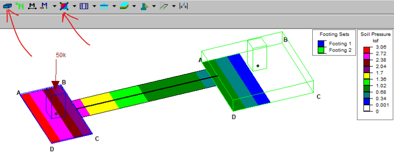

You should be able to get this visual, but you have to play around with the view settings. See screenshot below:

Risa allows you to model discrete soil regions, so you can create a soft spring soil to represent a compressible material, then create a region just below the beam. I've tried it before and the results have been a little inconsistent, but it is a tool that's available in the software.
