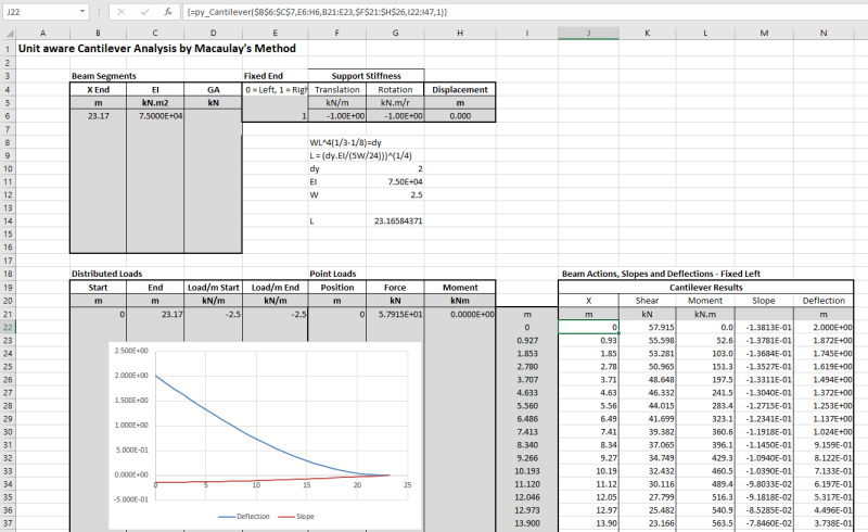

I thought Denial had beaten me to it, but I don't think his analysis is quite right.
Again assuming infinitely stiff support, the lifted part of the pipe can be considered as a cantilever with a point upward load at one end, an equal downward distributed force, and a point moment at the other end. The end deflection is therefore WL^4/3EI - WL^4/8EI, which gives the L required for an upward deflection dy as:
L = (dy.EI/(5W/24)))^(1/4)
Using guessed values for a concrete pipe of 0.5 m diameter of w= = 2.5 kN/m, EI = 75,000 kN.m2 and dy = 2m I get L = 23.166 m, which if I feed it into my cantilever spreadsheet gives me exactly 2 m deflection:
The end moment is about 670 kNm, which would be way over the bending capacity of an RC pipe of 500 mm diameter.
Also note that this assumes uniform stiffness. A segmented pipe with joints that allowed partial hinging would obviously allow a much shorter length, and reduced moment.

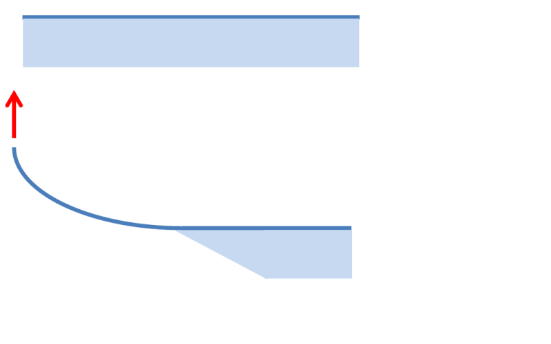

to me it seems reasonable that the ground contact force is reduced near the lift-off point, rather than seeing a step change in ground contact pressure. something like ...

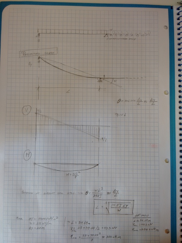

I see this structural system as following:
- Simply supported beam with span L.
- The Dy=2.0m vertical displacement in one end causes a rigid body rotation of the beam of value arcsin(Dy/L)=Dy/L;
- The pipe is loaded with a load w that causes a rotation at the end supports of wL^3/(24EI).
In order that the rotation of this point in contact with the ground is null, wL^3/(24EI)=Dy/L --> L=(24EIDy/w)^(0.25)
The internal forces are caused only by the beam self weight, so Vmax=wL/2 and Mmax=wl^2/8
For the data that IDS provided:
- EI=75000kNm2
- w=2.5kN/m
- Dy=2.0m
we should have L=34.64m; Vmax=43.3kN; Mmax=375kNm
For validation, I plugged this data into a SAP2000 model with compression only springs and the results are spot on for an end displacement of 2.0m.
I enclose a sketch of my calculations (sorry for the poor quality...).
this approach drives the lift force to be 1/2 the weight of the pipe, and zero moment at the ground contact point. I don't see that this is the only solution to the problem.
I think there's some point to the right of the contact that defines the affected part of the pipe; there'd be no shear force or moment on this section, similar to the pipe to the right of this point, the weight is continuously supported by the ground.

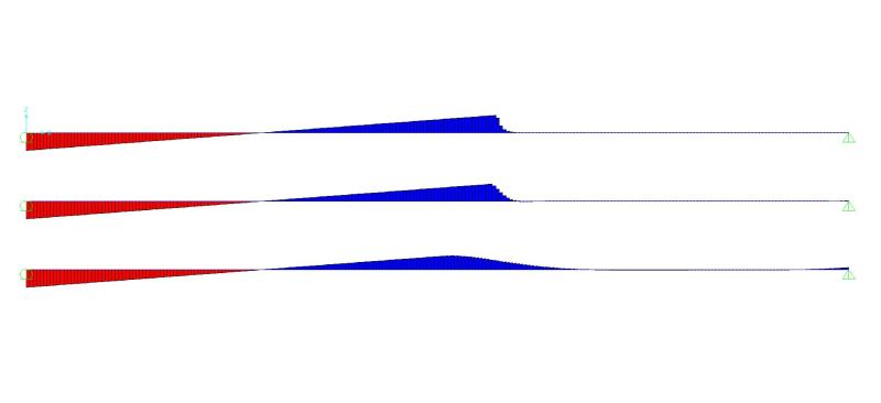

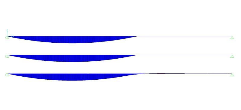

You're right. There's a small transition zone that depends on the relative stiffness of the ground and pipe. My SAP200 model was done with almost infinite spring stiffness so the extent of this area is quite limited. However, for practical purposes, I don't this as an issue.
I've run a couple of tests in SAP2000 with different compression spring stiffnesses (1E12, 1E6 and 1E3 kN/m/m) to see its influence on bending moments and shear. There wasn't a difference between maximum bending moments and shear forces greater than 0.5%. The difference lies entirely on the extent of the transitiion zone only. I've attached a couple of images showing bending moment and shear diagrams.
Bending moments:
Shear forces:

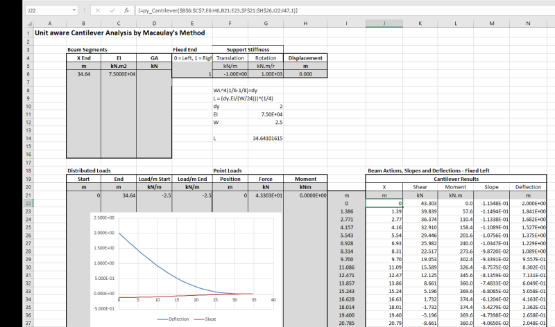

Apologies to Denial. He had it right.
For an infinitely stiff support, the curvature at the point of lift off will be zero, so the moment is zero and the pipe weight is distributed evenly to either end. With the corrected loads the pipe length required to be lifted is L = (dy.EI/(W/24)))^(1/4), and the lifting force is 34.64 kN (as found by avscorreia).
For a finite support stiffness, the lifting force and maximum moment are reduced, but not by very much. I get the following numbers from a Strand7 analysis:
Support Stiffness(kN/m/m) Lifting Force(kN) Max Moment(kNm)
100,000,000 42.8 371
10,000 42.5 371
100 37.3 290
Revised spreadsheet analysis, with the lifting force set to half the lifted pipe weight:
