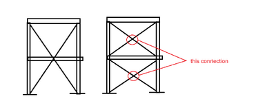

Correct design and detailing of X bracing in the middle Brace-to-Brace connection? (one story, so not beam there) 1
X4vier
Feb 24, 2018
167
CO
Is there any AISC document with the correct design and detailing for one story X brace for Special Concentrically Braced Frames (SCBF)
I can see the example in the seismic design manual for the two-story X-bracing with the beam in the middle, but there is no reference to the one-story X-brace.
The examples in this document are for two-story X bracing.
I'm looking for the design for X bracing with bracing crossing each other between the floors.
Then you would lose the "Special" in SCBF.
I'd suggest you look at an eccentrically braced system or a moment frame.
Isn't this type of bracing "tension only", and a connection at the crossing point is unnecessary, or only to prevent slapping?
They can still be designed as tension or compression if you detail/design it properly.
What exactly is your question? Is it in regards to the effective length of the compressive member in the X-bracing?
You can still maintain concentrically braced with double angles.
X-bracing that resists tension and compression is permitted in SCBFs. If you can track down the 2000 IBC SEAOC Seismic Design Manual, there is an x-braced frame example in Volume III. However, I'd recommend using a chevron configuration if you can. It's generally much more economical than x-bracing because you have 3 connections per bay rather than 5. If designing to AISC 341-22, the chevron beam would also be a little lighter than in previous versions of AISC 341.
