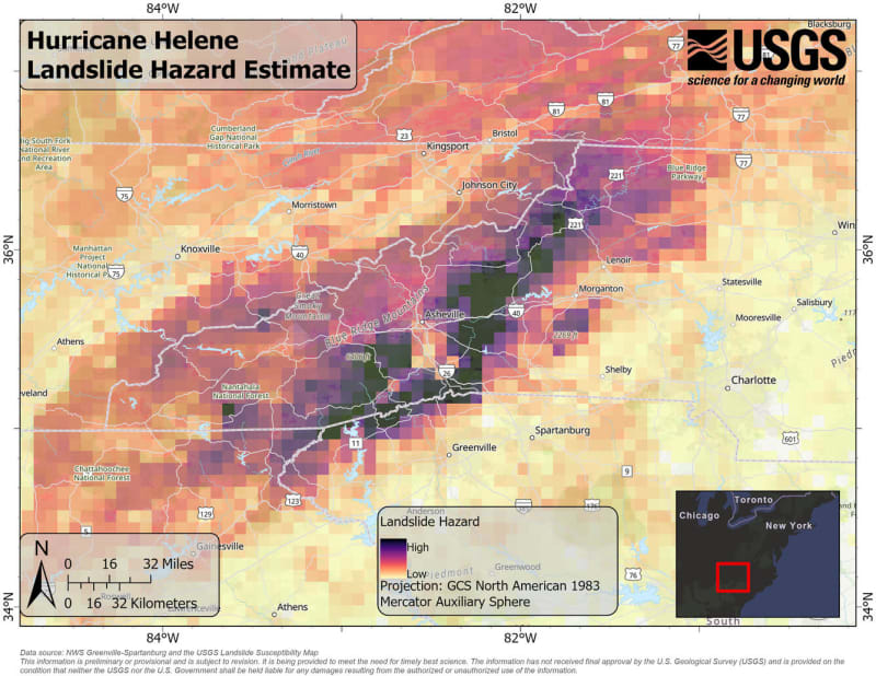

Lets get back to the FEMA maps. This video examines the geography of Appalachia which makes the area subject to debris flow. The flat areas at the base of the small streams are often the only relatively flat build able sites. These flat areas are where the debris flow deposit.
How should building codes / land use guidance address this situation?
What happened to mountainsides during Helene's extreme rains (30 inches or more)?
The Geomodels Oct 11 2024 Caption to video said:
Helene has impacted Appalachian life in extreme ways for the foreseeable future. In addition to catastrophic flooding, deadly landsliding occurred in numerous areas. The Garren Creek community of Buncombe County, North Carolina, may have been the area most severely affected by landslides. Huge debris flows claimed many lives in this area, and while the story has appeared on national news outlets, it has not received the attention that more populated areas have. This video talks about the disastrous debris flows in this area and how debris flows work in general. The video contains information for first responders about the risks of working in a debris flow area following the first pulse, as well as for mountain residents who may live in areas that could be hit by debris flows.

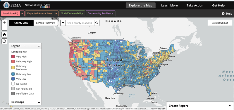

Agree. And it shows left coast has vastly more areas vulnerable than North Carolina and more densely populated with more buildings to determine dollars lost, therefore it does not addresses the actual risk of flooding event damage to a low density steep and narrow valley mountain topography.
A Landslide Expected Annual Loss score and rating represent a community's relative level of expected building and population loss each year due to Landslides when compared to the rest of the United States.
Perhaps biasing risk to high population centers vs rural low density areas is exactly what FEMA's Equity policy addresses??? 🤥
