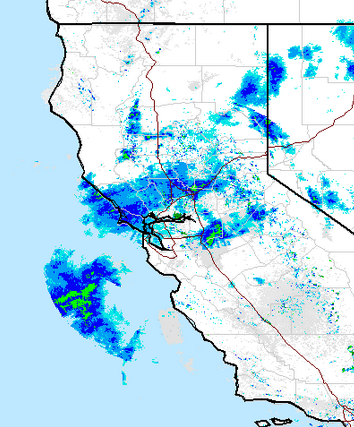

Yea, it looks like some weather is moving in from the Pacific (see the screen grab below from the current radar weather map):

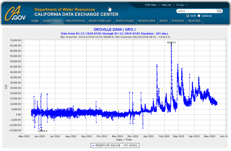

They have 170,000 Acre-feet of storage room 'left' in the Conservation pool. If you look at the rate of change in AF, you can see that even a month ago when the inflow was much higher, the reservoir was only gaining about 15-20K AF a day:

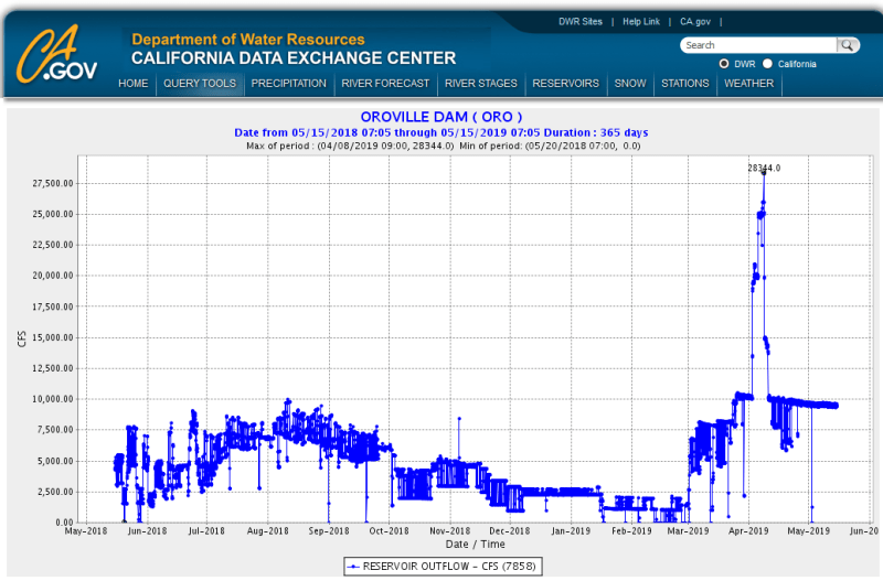

So far this season they've had a few spikes in the inflow of 40,000 CFS range with one burst at 67K CFS. They've tested the spillway at 28,000 CFS and by every indication it has passed with flying colors. It looks like for all intents and purposes that the system can handle whatever is thrown at it.

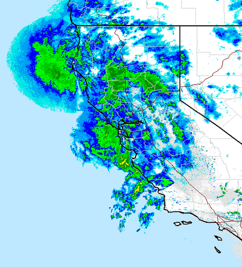

It appears to be raining in the Oroville area as seen both from the webcams and the weather radar (see the screen grab below from the current radar weather map):

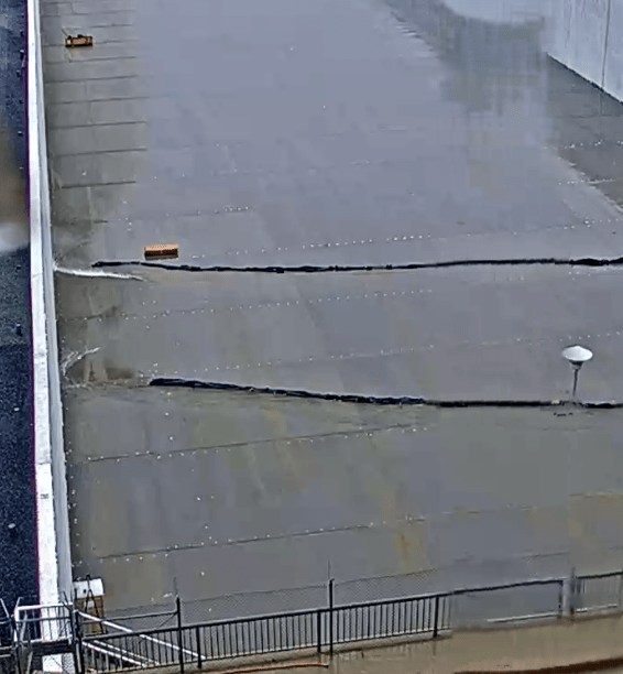

Any rain hasn't stopped work. There's lots going on right now.
Top Camera
Up spillway camera
That right most gate has got "the leaks". Oh wait. They put in sandbag dikes. They're all leaking uniformly as expected. It's just being herded down the left side. I think someone actually mentioned this earlier.

Anybody know what that wooden box like thing is a ways down the spillway?
Keith Cress
kcress -
I think it just a box they use to lift stuff in/out of the spillway.
As in Crane-in and out?
