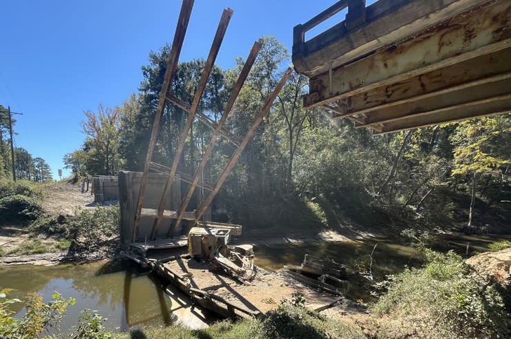

It looks like an excavator went down with the structure during the demolition phase of reconstruction. Sad.

A few years back a company I was working for had an issue with a collapse during a demo job. Someone forgot to weld some braces to the span to hold it in place until it was ready to torch it in half and lift the sections it of there. The excavator operator didnt watch his swing, hit the span with the counterweight and sent the span and a crane into the water. No injuries thankfully. All sites started getting inspected and on ours we found similar issues with our temporary platforms only being tacked and no cantilever braces. Thankfully we caught that just before we took delivery of new counterweights that were due to be stored near the edges. The welder's excuse for why he initially claimed it was all done was he didn't want to overhead weld on rusty steel between tide changes.

Seeng how the span here managed to find itself upside down with the road surface below it, I'm suspecting something similar happened that caused it to twist and flip off it's footing. At least that is how it looks to my eyes.
I'm terrible at analyzing pictures. All I see is twisted metal.

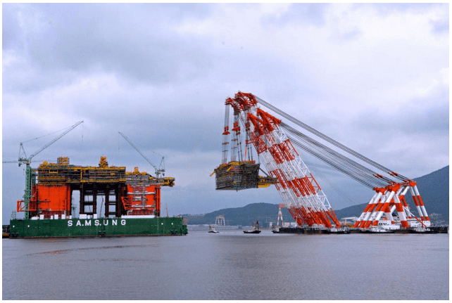

The 62 m-long, 46 m-wide, 6400 t module was the seventh of eight modules required to complete the CPF topsides. Maybe cranes large enough to do a lift can't get to all the places they need to.
Absolutely. Planning demolition work is driven by 1) access and 2) material removal. If a crane can accomplish 1, 2 is easy. But most of the time that's either impossible or cost/schedule prohibitive. So you end up finding a balance of what equipment can get there and reach, and how much that will make the material difficult to handle afterward. Explosives are great for #1 but they can make a real mess out of #2.
I think I see what happened now. The bridge deck was stripped off the far end of the structure leaving the skeleton frame work. This removed the counterbalance to the cantilevered center span. With the mini excavator on the center span, the centre span dropped, landing in the river intact while flipping the far skeleton frame on its end. This would be a case of poor planning.
NOt so sure. The digger is sitting right on top of the upper road deck and side supports which have fallen directly down some how.
but agree it lost some counterbalance and the beams have fallen off their supports.
The road deck had not been removed from the center span. That was the primary imbalance with the digger being the final straw. The frame sticking up in the air is from the far end of the structure flipped over the support. It's not from underneath the center span. It's a truly bizarre spectacle.
The center span was supported by cantilevers at both ends. The section of the far road deck that was atop the cantilever fell over onto the center span in the river. It is seen upside down.
This is exactly what it looks like.

The course they were going would have worked just fine had they secured the cantilevered spans from moving during demo and left torching attachment points for last once the beams were being carried by equipment.
