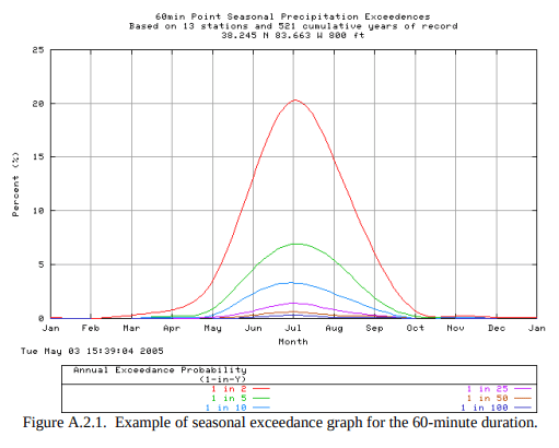

My understanding is that the FEMA flood maps do not totally account for pluvial flooding.
NOAA Atlas 14 Precipitation-Frequency Atlas is one input to the FEMA flood maps. If you delve into the technical underpinnings of the Precipitation Frequency Atlas you will find that an attempt to include the impact of orographic lifting was made, and recognized as imperfect.
Precipitation-Frequency Atlas of the United States Volume 2 Version 3.0: Delaware, District of Columbia, Illinois, Indiana, Kentucky, Maryland, New Jersey, North Carolina, Ohio, Pennsylvania, South Carolina, Tennessee, Virginia, West Virginia
This page on NOAA's website Modernizing Probable Maximum Precipitation Estimation indicates for lack of funding there was a gap in NOAA's efforts.
[URL unfurl="true" said:
https://www.weather.gov/owp/hdsc_pmp[/URL]]Since the late 1940s, the NOAA’s National Weather Service has provided PMP guidance and at the request of various federal agencies and with funding provided by those agencies. This funding has diminished and gradually ceased, and as a result the NWS could not continue the PMP activities.
With the 2022 Bipartisan Infrastructure Law (BIL), NOAA received the first-ever direct Federal funding to update PMP estimates for the entirety of the United States. To assure that the best science is applied to this important task, NOAA is first sponsoring a study by the National Academies of Science, Engineering, and Medicine called “Modernizing Probable Maximum Precipitation Estimation.” Please see the project website for more information and a way to sign up for project updates.
One of the referenced documents, likely an input to the current atlas 14 is Probable Maximum and TVA Precipitation over the Tennessee River Basin above Chattanooga June 1965
This whole process is technically challenging, and requires data which requires the passage of time (unless you want to create the data from weather models, which would increase the uncertainty of the result).

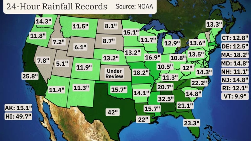

K​entucky is the most recent state to set a new 24h rainfall record – 11.28 inches on July 18-19, 2023.
That was a year ago and may be outdated already, given its not so far away from Helene's track. A weather model considering possible variations in Helene's track might indicate if KY 11.3" still looks adequate, or if it needs to look more like TN 20.7". I have not seen Helene's 24h rainfall data yet. Could make for a very interesting comparison.
(I did not know that TX had 42". And I'm wondering how ITH LA escaped a similar fate.)
Texas got 42 inches due to a NOAA reporting station ( being at the location of the record rainfall so it could become part of the official record.
42 inches, set in Alvin, Texas, on July 25-26, 1979, when Tropical Storm Claudette soaked the state.
Except for no official reporting station being present at the location of heaviest rail, virginia would have a record rainfall close to 40 inches.

Oddly enough Claudette came ashore close to NOrleans, but Tx got the rainfall record. That seems very problematic, as I can't see any reason that Lousiana could not experience a similar 42" rainfall in 24 hours, yet their 22" in the map above is nowhere close to 42. It would seem that the potential for 42"/24h also exists in LA and MS, GA, FL, AL. SC, NC and VA. I believe that illustrates exactly why we cannot entirely depend on actual records to predict future events. Noting that these storms were not recent events, possibly entirely free of climate change effects, there may be some potential for even greater magnitude events waiting around the corner. Modeling max possible storm intensities might fill that gap. In fact without it, we may be sitting ducks.
Note that the record historic 24h rainfall is probably not used in delineating flood maps, since an all-historic record may translate into a return frequency of 1000yrs. We need to have a look at current maximum potential rain frequency records and see if they may be underestimated because of being based (supposedly) on actual data alone. I had a look at the Max Precipitation calculations of California, since that was the latest study of 1998. They attempt to model the individual basins. Since that one is now 25yrs old, all of these reports are surely based on more rudimentary forms of analysis and may benefit from more modern techniques that have certainly become available since then.
