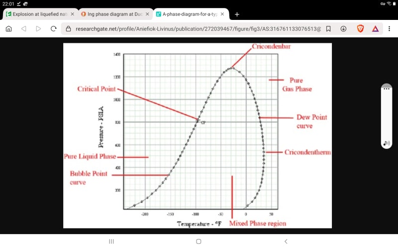

NG Phase diagram
They probably were somewhere in the mid to lower central mixed phase region.
