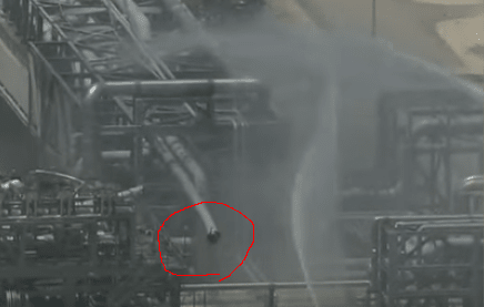

This image has something that looks like a missing section of pipe and elbow.

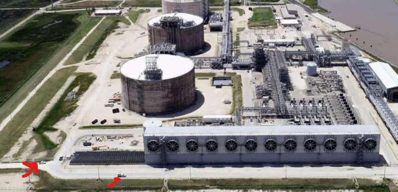

FacEngrPE - I think this picture gives a good perspective. Look at the trucks in lower left for scale
(2B)+(2B)' ?
268 ft diam measured in Google Earth.
100ft high estimated from number of stairway flights to top.
6MM(Actual)CF (150,000 m3)?
At a gas to liquid conversion of 600:1, its 3T scf/tank.
At US Production of 100BCFD, its 30 days/tank.
Typical LNG ship capacity is 125,000 to 260,000 m3, so tank sizes are right about in the middle of that range.

Freeport LNG released information last week that the LNG piping became overpressured and believes the issue occurred in the pipe racks supporting the transfer of LNG from the storage tank area to the terminal’s dock facilities on the Intracoastal Waterway or north side of Freeport LNG’s dock basin.
..... So now it looks like it's the Pipe Racks !!!! .... It's always those damn troublesome pipe racks !!
Naaaaaaaaaaaaaaaaaaaaaaaaaaaa..............
I still put my money on a piece of renegade carbon steel pipe that was welded into a cryo system by two TEXAS pipefitters named Jethro and Billy Bob .... They ran out of the 304 stainless pipe that was required for the job ..... so they used an old "pup piece" that they found out in the "back boneyard"
Jethro was heard to say: "Uh pipe iz uh pipe !, Ah reconn .... Ain't no sense in a-payinn my mind to no fancy "Pee-an-Eye-Dees" !!!!
