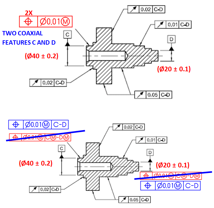

Since I do not want this thread to be extinct and also based on an earlier discussion with pmarc about examples of equivalent dimensioning and tolerancing schemes, I am posting two schemes below (I guess they are above) and questioning their equivalency.
This is what I understood from the discussion, but I also might be wrong and misunderstood previous statements.
So, here you are: are those datum schemes equivalent? If not, how to make them to have the same mathematical definition, if all possible?
I realize, might not be entirely possible, but I am tossing it out there.
Thank you for your input.

1) I know what your intent is for your first scheme, however because your example has several coaxial features the meaning is somewhat ambiguous. The fact that you are referring to the two datum features is maybe implied but not explicit - perhaps something like a note "TWO COAXIAL DATUM FEATURES C AND D" or similar, however others might find that cumbersome I'm not sure.
2) In your both schemes (#1 2x pattern at MMC and #2 2x features at MMC and C(M)-D(M) at MMB) you have datums which are defined at MMC/MMB that are utilized for runout which must be at RFS/RMB. Because of this wouldn't you want to define your datums at RFS/RMB as well?
Other than the slight technicalities of my notes 1/2 and accepting that you've brought this up as just an example I would think that yes, these two schemes are equivalent as far as I can tell.

greenimi,
I agree that the two schemes are equivalent under the assumption that "TWO COAXIAL FEATURES" means datum features C and D.
The example seems pretty strange though. A similar example would be adding a tertiary datum feature reference of C(M) to the position tolerance applied to datum feature C in Fig. 4-9 of ASME Y14.5-2009. It wouldn't change anything, and there's probably no rule prohibiting it, but what purpose would it serve other than causing confusion? You're basically creating the same boundary twice, once with the position tolerance and once with its datum feature reference.

Looks like “people’s choice awards” goes to blue scheme, doesn’t it?
I assume my modified scheme (in blue) fits better the thread scope per the above comments.
Datum feature C and datum feature D are different nominal sizes. Maybe that's why it's best to not lump them together with the same feature control frame.

Belanger:
The standard seems to be OK with two features of different sizes:

The problem I can see with composite is the features we are trying to control are the datum features in other words are the driving features and not the driven ones.
I can see how to used composite tolerances on the driven features, but not so much on the driving ones.
The picture I used is from the standard (2009) and I've modified it to fit my purpose.
Maybe you can offer a sketch for a potential solution, I am all for learning.

greenimi,
ASME Y14.5-2009 does not define how datum axis C-D would be derived from RMB datum feature references. That being said, I think your two new schemes are probably equivalent. I can't think of any geometry that would meet the requirements of the upper scheme but not the lower.
I think the lower scheme from your latest image is even stranger than what it replaces though. In this case, a similar example might be adding a secondary datum feature reference of B(RMB) to the position tolerance applied to datum feature B in Fig. 4-26 of ASME Y14.5-2009. I can't imagine why anyone would want to do that. Can you?
Maybe not exactly "how" but many of the runout examples are utilized with self referencing RFS/RMB datums (due to the requirements of runout) and when I made my comment I figured something more along the lines of my #3/4 below. I agree the mixture of MMC/RMB is strange and somewhat difficult to conceptualize.
The possibilities I see are below:
1) 2x ⊕ ∅0.01(M)
2) ⊕ ∅0.01(M) [C(M)-D(M)] *applied to each datum feature C and D
As far as I can tell #2 is equivalent to #1, if not redundant as the MMB boundary of C(M)-D(M) is already controlled by the MMC condition of the 2x pattern in #1.
3) 2x ⊕ ∅0.01
4) ⊕ ∅0.01 [C-D] *applied to each datum feature C and D
Once again I believe #4 is equivalent to #3, if not redundant as the RMB boundary of C-D is already controlled by the RFS condition of the 2x pattern in #3.
5) 2x ⊕ ∅0.01(M)
6) ⊕ ∅0.01(M) [C-D] *applied to each datum feature C and D
My gut says #5 and #6 are equivalent but it just doesn't seem to follow logically as my brain says they shouldn't be because #6 with RMB is the same as #2 with MMB applied. The only way I can rationalize it is because they are self-referencing and in any other case where the controlled features were not also the referenced datum features (non self-referencing) they would not be equivalent - additionally in this case the datum references only serve to hold the features in basic location (0 - coaxial) to each other and any boundary created is redundant. I cannot seem to think of a case where #2 would pass a part and #6 would fail a part.
Note I did not include the reverse of #5/6 with RFS position/MMB boundary because I don't believe it would be valid to have an MMB boundary applied without an MMC position control.
