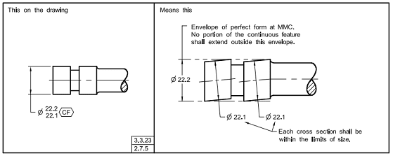

What about <CF> modifier? Would there be a way to define the same requirement without using the <CF> symbol?
In many cases, something similar could be achieved with [box]position[/box][box]0 (M)[/box] SEP REQT or [box]position[/box][box]diameter 0 (M)[/box] SEP REQT. I only say similar because there might be a difference in the determination of actual local size, depending on the definition you feel like using.

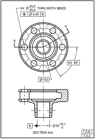

ASME Y14.5-2009 Fig. 2-5: Remove dimension origin symbol, make dimension basic, identify datum feature, apply profile tolerance.
ASME Y14.5-2009 Fig. 4-5: Change perpendicularity to position and remove references to datum features B and C.
<CF> simply means that 2 or more features are sharing the same envelope:
Similar effect may be achieved by note, declaring that 2 holes are in fact 1 hole - what are you going to do?
For <CF> that is not feature of size

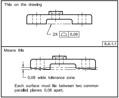

Profile for coplanarity will serve well:

Additionally, could you elaborate what you mean about figure 4-5? The only perpendicularity callout I see is on the single center boss of 25.1/25.0 and if you change that to position its only reference is to datum A already which would only control orientation which as far as I know is not acceptable with position.
pylfrm,
Like chez311, I am not sure I see a need for SEP REQT. Per my understanding this would do exactly opposite to <CF> concept - two or more features would become totally independent of each other.
Agreed on fig. 2-5.
As for proposed modification of fig. 4-5, I believe you meant something similar to this:
Am I right?

You may disagree with me, but I personally do not like the idea of using notes like THRU ALL or THRU BOTH SIDES to indicate that two or more features share the same MMC envelope. This is not "programmatic" way to say that continuous feature is the intent. By "programmatic" way, I mean a way that could be automatically consumed downstream (by CMM for example).
Agreed on the <CF> vs. profile equivalency in case of planar interrupted feature (although if possible, I would like to avoid discussion on whether use of <CF> modifier for non-features of size was really the committee intent or not).

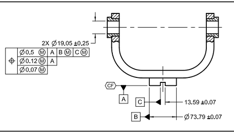

Let me ask you this. If you were to use CRDF concept in position FCFs applied to dia. 9.2 hole and pattern of four dia. 5.1 holes in fig. 4-19, how would the FCFs exactly look like?
Am I right?
Yes.
I'm not aware of a prohibition on position tolerances that only control orientation. I realize this is a popular topic for debate, but I don't see a problem with it. Regardless, that is not the case in my proposed scheme. The three position tolerances would all be part of a single simultaneous requirement which controls location.

Using CF on a pair of interrupted surfaces (CH's snippet of Fig. 7-45) is not "equivalent" to using profile of a surface for coplanarity.

In order to be fully defined the interrupted surface on CH's snippet would most likely have to be controlled with flatness tolerance. If the value of the flatness tolerance was 0.08, wouldn't this be equivalent to the datumless profile of 0.08?
Somehow like this:
That is correct. So by doing this, where exactly did you make customization of degrees of freedom? Or putting it differently, did you really make any customization?

So, without customization [C] controls 4 DOF, after customization [C] controls 1 DOF. Where do you see the problem?
This is where I see the problem. C is able to constrain 4 DOFs only if it is primary datum feature. In this case it is tertiary, so it can only constrain 1 DOF because other 5 have been already constrained by datum feature simulators A and B.
In other words, your proposed scheme is not overriding any degrees of freedom and is no different from what is shown in fig. 4-9 in Y14.5-2009 - there is no need to specify [w] after letter C in both position callouts (just like there is no need to specify any degrees of freedom after A and B), because that is the only degree of freedom that can be constrained by datum feature simulator C. One might say your scheme is redundant in this case.
To me it seems like your intent is to use CRDF concept to override default requirement for basic location (distance) between datum feature simulators B and C. Well, this is not what the CRDF is about. Notice it is not mentioned in para. 4.5.2(c) as a way to override this basic relationship. If one wants to have the relationship overridden, the Translation modifier is the choice.
C is able to constrain 4 DOF all the time.
The part on 4-9 is overdefined.
The translation modifier is a lame attempt to give datum simulator C extra degree of freedom, that's what it's all about.
The confusing way to add extra DOF vs. precise way to control any DOF any way you want.
