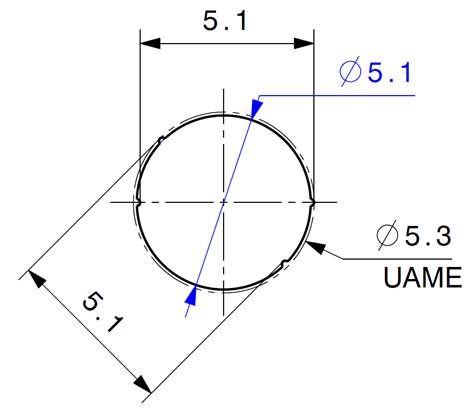

I don't know why anyone would want to do it but here is what came to my mind:
- A cylinder of size 5+-0.1
- A cylonder cylinder of size 5+-0.1, cylindricity within 0.2, and a note stating "PERFECT FORM AT MMC NOT REQUIRED"
semiond
greenimi,
You weren't very specific so I won't provide counterexamples, but none of your proposed schemes can be equivalent unless the tolerance values are zero.
Sem_D220,
Your second scheme allows a feature with UAME size of 5.3, which would not comply with the first scheme.
pylfrm
pylfrm,
I say the first scheme will accept it too.
Note how the actual local size is not greater than 5.1 everywhere on the perimeter.

I did not provide an example, but I would think that for the sake of discussion we can come up with some.
semiond,
Since your first scheme is subject to rule#1 it must fit within a cylinder of perfect form at MMC. This would be 5.1 - the deviations you show in your sketch would not be allowed under rule#1, they would be violating that cylinder of perfect form at MMC even though the local size is not greater than 5.1
greenimi,
I agree with pylfrm. These are not equivalent schemes.
I hope someone will do it earlier, but if not, I will try to post a sketch later today to show this.
semiond,
I agree with pylfrm on that one too - the two schemes are not the same.
In the first one, the cylinder produced with all actual local sizes equal to 5.1 (MMC) must not have any cylindricity error, otherwise Rule #1 is violated. In the second scheme the cylinder produced with all actual local sizes equal to 5.1 might still have cylindricity error of 0.2, meaning that the size of its worst-case outer boundary will be 5.3.
Your sketch shows a condition of the cylinder that would not be allowed in the first scheme - the actual contour violates the envelope of MMC size = 5.1.

I can't believe I totally forgot about rule #1 and didn't realize it even after being pointed out at it by pylfrm.
What confused me is the fact that rule#1 is supposed to apply a form tolerance equal to the size tolerance. But right now I'm confused. The inner boundary for scheme #1 seems to be 4.8 , MMC is 5.1 . Is it possible that the maximum form error is 0.3?
Edit: pmarc, I just saw your last post. I realized my error, but as you can see still confused [ponder]
Ok, I think now I got it.
The inner boundary for scheme #1 is 4.9 4.6 (another error [sad]). The total allowed form error is 0.2. In the second scheme, if the note PERFECT FORM AT MMC NOT REQUIRED wasn't included, the two cases were the same but the cylindricity tolerance would be redundant. Sorry for the bad example [blush]
semiond,
Actually I believe the inner boundary would be 4.7 as per 2.7.1 (rule #1):
"Where the actual local size of a regular feature
of size has departed from MMC toward LMC, a local
variation in form is allowed equal to the amount of such
departure."
So at LMC the form error allowed would be 5.1 - 4.9 = 0.2 which means the inner boundary is 4.9 - 0.2 = 4.7
I think you are correct though, if "PERFECT FORM AT MMC NOT REQUIRED" was omitted from your scheme#2 the cylindricity would be redundant as it is the same as the form error allowed at LMC (0.2), if it were smaller it would no longer be redundant.
