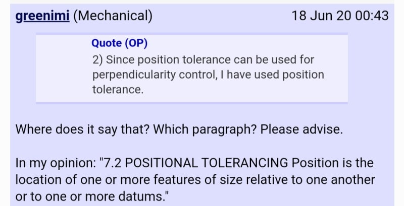

position instead of perpendicularity on datum B

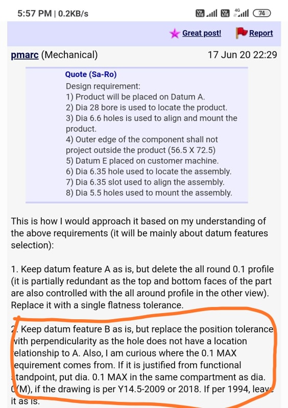

Kindly refer my earlier thread: profile tolerance for location control
Pmarc and you have suggested to change the datum B from TP to perp. Since there is no location from datum A.
Based on that guidance now I have provided perp instead of TP.

Sa-Ro ... In that other thread, you had one hole as datum feature B. A single hole and the plane it intersects have only an orientation relationship, not location.
In this case your datum B is created from two holes. So while those two holes still don't have a location relationship to datum A, they do need to be controlled for location relative to each other (using the position symbol, not merely traditional ± tolerancing).

Single hole: perpendicularity
Multiple holes: position (you put 2x near the size dimension, meaning the pattern creation "mechanism" invoked)
Position will be able to establish a mutual relationship between the holes.

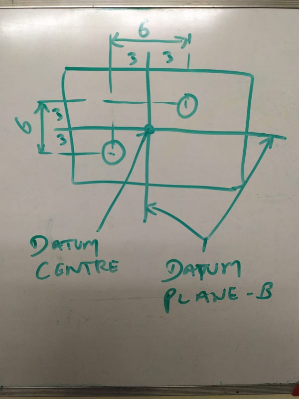

Where will be the datum B plane?
In between two holes?
What about equally disposed from datum B?
As mentioned in my drawing, wrt datum A B, other features (45 and 11) are equally disposed from datum B?
That would be defined by the basic geometry and the datum feature/simulator relationship, as well as the type of tolerance applied.
The tolerance zones for the 45/11 widths are symmetric about the simulators for B, as defined by the basic geometry. The actual features can be anywhere within their respective profile tolerance zones to |A|B(M)| (satisfies simultaneous requirements too, actually) and since B is modified at MMB the part can shift depending on the amount that the datum features B depart from their MMB.
