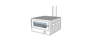

I'm thinking about converting an old RV oven to a heater for a van camper. The air intake would come from outside so when the door is shut it would be sealed. I would open the door and light it manually, so I would know if there was any gas in the box also have a gas detector and a flame sensor so the gas would shut off if it went out. This would be in the room like a wood stove a few feet of the floor. I have some computer fans that are very quiet I could use to blow air through the 3 tubes.
If you have any suggestions, or see any way to make it more safe and efficient please let me know.

Sounds like recipe for potential disaster; there are already research that show that, at least for natural gas, many health risks from the burned and even the raw gas supply, and unless you have multi-redundant safety systems and interlocks, it's a high risk. The more complicated you have to make your system, the riskier it is.
So are you ducting the air in and burnt gas out? Have you tried this as the burners are probably not designed like that and may not burn the gas properly and you risk incomplete combustion unless the inlet and exhaust duct is really quite big and very short. You might want to locate it outside and forget about these ducts. Incomplete combustion causes sooting, CO (make sure you have a working CO monitor) and inefficiency.
You need to seal those holes quite well to avoid heat loss and gas entering the cabin.
Your tubes should be finned to increase heat transfer from the oven and if you have this inside do the same on the exhaust pipe then add a cage around it to avoid burning yourself on the exhaust pipe.
At least here you have some temperature control but you will burn a LOT of LPG as this is unlike to be more than 50% efficient.
Keep the oven the same as it was before as much as you can and think about putting it outside in a box and get insulated air ducts into the RV.
Or run a copper coil inside the oven and run water through it like you were planning before as this would be a much smaller hole into your RV.
Any details of the oven to see how much lower it could give you?

I have considered these things, first I would definitely test it extensively outside before considering installing it. The oven is in my RV now, I disconnected it years ago and use an electric one. Many RV's use propane ovens, the only difference is that the box would be in the room to radiate the heat rather than contain it. The oven exhaust doesn't even go directly outside, it just vents to the top where the burners are and then all that supposably goes out the hood. This would go all the way up and out. The RV furnaces which are under the cabinets use a powerful fan to blow the heat out. They have to have a fan on start up to purge the chamber before they can light. If you think this would be about 50% efficient how efficient are those? Is there anything using LPG that would more efficient?DSCN2456.JPG

I thought it is pretty clear in post #25 that the exhaust goes out the roof, it's just like the wood stove I've been using for 10 yrs. It's sealed, gets air from outside and smoke goes out the chimney, exactly the same only different fuel. I've looked at the type in your link, it's similar to this one

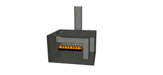

or an RV furnace. (not at all what I want) Nobody talks about how much noise the fan makes or how much power it uses. I don't even need a fan for the one I build. Maybe I'm missing something but I don't see how any of those other heaters could be as efficient. My question is weather there would be any advantage to have the tubes just have the burner close to the top.

You did say that, but then I got a bit confused in post #28 when you said "The oven exhaust doesn't even go directly outside,".
Anyway a picture tells a thousand stories.
The issue I see is one of heat exchanger and heat output.
The furnace thing can be outside the RV, but it is optimised in terms of heat exchanger size, burner controls etc to maximise efficiency to heat air to about 60 or 70C being blown out of the air duct. An oven is designed to heat up fairly rapidly to 200C plus, but with an essentially static air flow other than convection and very little new air being added. The heat exchanger surface is really quite small though and hence its efficiency in terms of what you want (hot air) is going to be low. You could increase it by adding an external mesh plate surround to the exhaust and allowing air to circulate around it whilst guarding against burning yourself.
So if you drill holes in the oven as shown - and you would need air input at the bottom - yes you will get some warm air drifting out of the oven, but it will either be too hot and things close by could melt or burn, or more likely you would just not get that much heat out of it, maybe a few hundred watts. One thing you do need to do regardless is block off that vent hole at the back of the oven which was used before to vent steam and cooking vapours up the vent. If you add a chimney you could either drag in warm up up the chimney or have flue gases entering the room.
If you're going to try this, my recommendation would be to remove the door and then blow in air using a couple of the bigger 12V computer cooling fans (very quiet) from the top surface. Also add in a layer of those lava rocks from a BBQ to increase surface area on the bottom surface. Set the thermostat to no more than 70 or 80C just in case. you can control heat by turning on or off a fan.
does that make sense?

remove the door, block off the vent? Do you not understand I'm building a new box and the combustion area is sealed from the room? The photo of the oven was just to show how it was vented. I may use some of the parts but the oven is history. I have fans with PWM variable speed control, they are as quiet as you can get, still I want to design the box to work best as possible without a fan. The reason I posted on this engineering forum is to get some advice about how to maximize the efficiency of the box while its still on paper. How best to get the most heat from the flame to the air in the room with as little heat loss through the chimney. The example in post #35 is similar to something I saw that would heat the air in the channel and create some air flow drawing cooler air from the bottom and exiting the top. I don't know how well it would work or if it would be worth it.
Ah, I thought you were planning to use the oven as it was redundant and actually still think that's a good plan as you're using recognised components.
OK, if you're starting from scratch then I would build something tall and thin with a set of fins on it or a set of tubes with a collector manifold at the top to vent outside.
The longer you can make the tubes the better, but for a simple design your flue gas temp needs to be prob min 150C as you exit otherwise you'll get a load of condensation and corrosion. Probably need a bit of trial and error to see how many tubes and how long they can be versus amount of gas in. Start small.
The issue with the item in #36? is that there is actually very little surface area and hence the box and tube will just get very hot before the reach equilibrium with heat energy in equals heat energy out and the flue gas will be very hot which for an RV and for efficiency isn't good.
So I thought something like this?
OK, now were getting down to it! I had not thought of anything like that but it makes sense. Thanks
