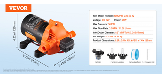

Maybe this is not the right forum for this but I'm not looking for a heater. I looked at those, too loud, I don't want to mess with another fuel and too many other disadvantages. The add claims the Vevor will run for 8 hrs. on 1.3 gal. of diesel, it doesn't say how big an area it would heat to what temp. or how much DC power it uses. I want to compare efficiency, but it's not the main priority. I have a tiny wood stove, it wouldn't be my primary heat, Just something I could leave on all night and raise the temp. a little when it's freezing or when I don't really need the wood stove. I want to concentrate on finding what it would take to make this work, which pump would work best and what I need to do to heat the water to a certain temp. and circulate it through exchanger. what the water temp might be going back in to the heater how often it would have to shut on or off to maintain a certain temp in the exchanger. I already have a heater, I need pump and an exchanger to try it. I may do this anyway, I was just looking for a little helpful advice.
Probably best now to start a new thread in the Engineers with hobbies forum.
Your issue with putting this together from a handful of separate bits is getting the sizes to match and for any temperature controls to do their thing. Finding out what the dead band is for any heater temperature control is probably the hardest thing to find out, but you probably need an on off ranfemof at least 10 C.
That heating coil needs a fan to blow air as opposed to a simple radiator. That LPG heater is just too big and will simply start and stop frequently. The pump might be OK, but the flow might be a bit high.
I would still include somewhere a bit of thermal mass in terms of a hot water tank / vessel to smooth out the temperature fluctuations.
Does that make sense?
