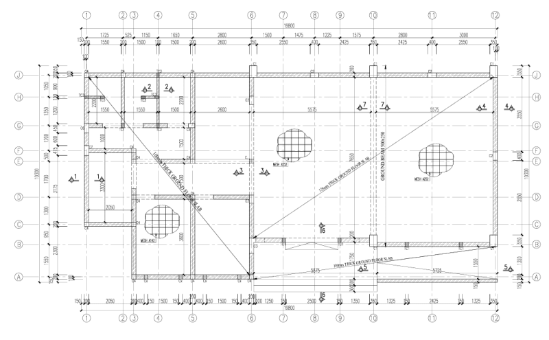

Dear fellow structural engineers,
I am a graduate engineer tasked with my first job ever of designing a G+1 by hand calculations only.
I have my basic understanding of analysing frames and members, however I need advise on the following;
i)Calculation of the centre of mass of the structure and the centre of rigidity
ii)wind load calculation on the structure.
I will be updating this thread constantly for those willing to guide me and upload calculations for those who might require it.
We are designing using BS8110 and CP3 for wind loading.
I will attach the DWG file soon.

i) Calculation of the center of mass and center of rigidity will be an iterative process. You'll take the floorplan and make an intelligent guess, work through your design, then revisit those guesses to see if they are satisfactorily accurate or require adjustment (and repeated design). How many iterations will depend on how complex (and hard to guess) the floor plan is.

This is the floor plan to be repeated on 1 more level
What is interesting is the structure is not a total frame structure, as it is load bearing on GL 1 to GL5.
What do you all think of this?
This column layout was proposed by my Superior.
