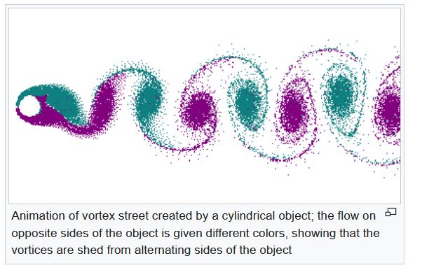

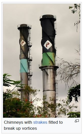

Find out all you can about Vortex Shedding, because it is sure to be a major factor in the your design. It is often mitigated using strakes as illustrated below.

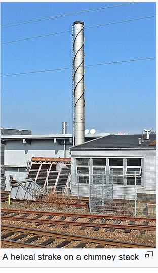

Here's another strake. This one is in the form of a helix.

Thanks for your input. Yes you are right. Vortex shedding phenomenon is important in the design of flagpoles. It can take place even in the wind speed between 15 to 60 km/hour. Strake may be one of the mitigation measures. But the provision of dampers at appropriate heights of the flagpole can also mitigate vortex shedding. We need to also perform fatigue analysis and ensure that the threshold stresses are with in the limits specified and defined in ANSI/AISC 360 Specification for Structural Steel Buildings. see the attached brochure for more details.

You don't find strakes on flag poles as they tend to be a tapered design especially at that size or incorporate other anto vortex mitigations.
And they look terrible.
OK for a chimney, not OK for a flag pole.
