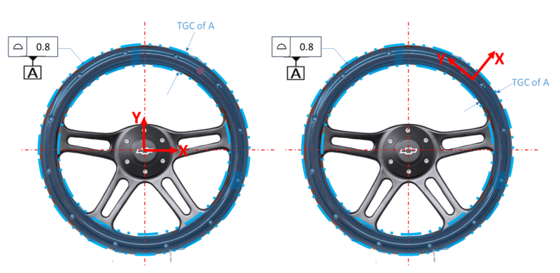

Please see the following diagram.
Do you think, based on the Y14.5 standard, that the shown curved line could be a valid datum corresponding specifically to the "line" type (and only) in the above definition? If not, why?
So why the situation feature has been introduced in ISO? What is its purpose?
Is it more like a "general term" that groups together other ISO terms (like planes,lines, points) ?
Is there an equivalent in ASME of this name "situation feature"?
Looks like you clarified that TGC in ASME is the "associated feature" in ISO GPS therefore maybe "situation feature" is more general term for the "associated feature"
Could someone clarify my confusion, please?
I am afraid I am more confused about ISO terms than ASME ones😜🤣

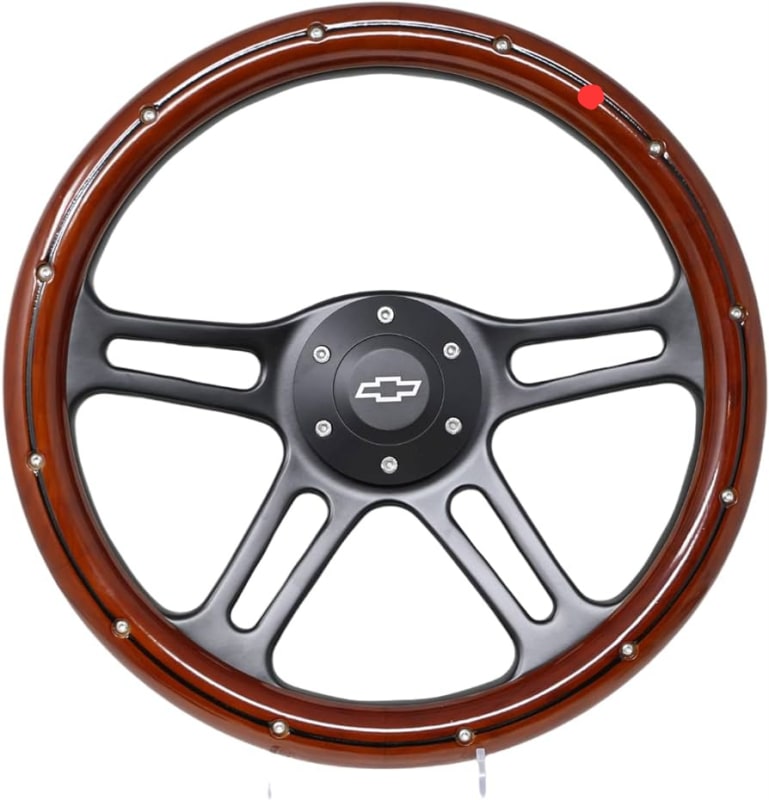

What if I don't want to show the DRF CSYS on the drawing. I could want to only interpret it as a 3 planes and 3 axes set located wherever I want (fixed relative to the TGCs) and establish it that way in practice, as a measurement reference. But that is not really possible without losing the clarity of the constraints, is it?
Burunduk,
If you don't show the DRF CSYS, then all you can unambigously do is talk in terms of the number and types (rotational vs. translational) of DOFs constrained by each TGC. But you cannot precisely label/name the DOFs like x, y, z, u, v, w.
pmrac, but in this case, to unambiguously tell that a torus shaped feature's TGC leaves one rotation unconstrained, I still have to assume the that the free rotation's axis is the axis of the torus shaped TGC, and acknowledge that it is also an axis of the DRF (no matter whether it's labeled x, y or z). If I want to place the DRF origin arbitrarily, such as on the spine of the torus, considering an unconstrained rotational DOF would be like trying to rotate a wheel about the red point.
Since you can't do that, it already sets the DRF at a specific location that can't be altered (except along the axis). That is what I've been saying. Maybe then it isn't true that the DRF can always be established anywhere as long as its location and orientation is constant relative to the TGCs?
Burunduk,
I am not sure I see a huge problem with placing the CSYS at the red point as long as one does not start to customize the DRF per Y14.5 rules.
My follow up question is: why CSYS cannot be altered?

In the following image, in both cases the primary datum feature is a torus. The TGC of datum feature A envelopes the actual torus and immobilizes the part somewhat. On the left side the DRF is established at the center of the torus which would probably be considered the most natural placement for it. In this case it's quite clear that 5 degrees of freedom - 3 translations and two rotations are constrained, and one rotation is unconstrained. The rotation which is unconstrained is about the torus' center axis (w). On the right side the DRF is established on the central spine of the torus shaped TGC. The ZX plane is coincident with the torus axis so it's not even "completely arbitrary". Is it clear in this case which DOF are constrained and unconstrained, and are they the same as in the first case? I would say not quite, and no. u,v,w rotations seem to be constrained and so is the z translation. x and y - they are kind of constrained because you can't move the part straight and directly in either of these directions, but also kind of unconstrained since the tangential (to the spine) transformation is possible, which has components of x and y, but the direction is not constant around the torus. In short - the result of not placing the DRF in the center results in unclear situations.
Burunduk,
In the picture on the right you get into the trouble because you want to give names (such as u, v, w, x, y, z) to the DOFs based on the CSYS shown. I agree that placing the CSYS on the spine isn't natural and may lead to confusion, therefore most people, including me, don't generally do it that way. However, this, in my opinion, should not mean the CSYS cannot be put elsewhere or be oriented at any other arbitrary angle, as its orientation and location have generally no effect on the number and type of DOFs constrained by the toroidal TGC. In other words, regardless of where you put the CSYS, 5 DOFs (3 translations and 2 rotations) have been constrained - no more, no less. Also, if the datum feature was a complex geometry (much more irregular in shape than the beautifully symmetrical "complex" feature shown in fig. 7-3(g)), based on what criteria would you recommend defining the default location and orientation of the CSYS?
pmarc,
I agree about "truly" complex datum features, such as Tandler's "Point-on-Line-in-Plane" datum type. There is no way to tell where the point and line must be if they must be in only one location (and orientation for the line) relative to the datum feature and the TGC.
However, with the torus, I'm still not certain more than one DRF location makes sense. If we want it to be clear that "5 DOFs (3 translations and 2 rotations) have been constrained - no more, no less" as you say, and someone can't see what the unconstrained rotation is about, don't we want to point to the center of the torus and say - "the part can rotate about this axis"? If yes, isn't it where an axis of the DRF should be located? Note that I'm not giving that rotation a specific name - could be u, v, or w - doesn't matter. I'm used to thinking that the DRF axes define the directions of the degrees of freedom that are considered as part of the constraints applied by datum references. Is there any other way to look at it? I can't see how a rotational DOF is available about an axis located anywhere but at the center of the torus. Do you see it differently?
