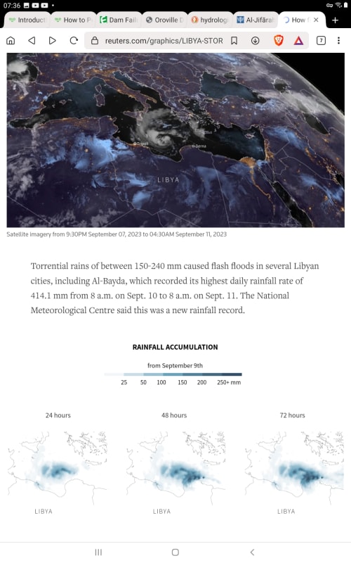

Can we stop arguing about whether the weather set new rainfall records.
It says it did here. 414mm/24h
Unfortunately 24h is often the best available resolution and we don't get hard evidence of maximum rainfall intensities over shorter durations.

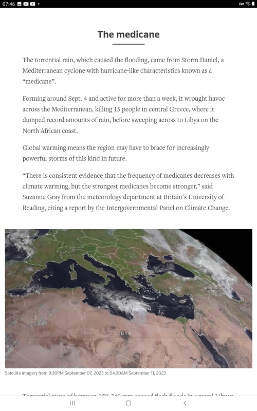

Hi Brian. Yes I understood your point was to explain there were other causes at Oroville. What I want to do is emphasise that I take the root cause of failure of the Derna dams as an extreme weather event that caused an overload on the dam. Whether the dams actually failed because of pressure from too high a water level, tunnel erosion at the dams base, a geologic fault, spillway overflow-erosion-destruction event, a construction defect, or maintenance issues is not important in the context of whatever broke the camels back was initiated by the extreme weather event.
What I am getting at is ...
If it didn't rain 414mm in 24 hours, none of this would have happened at all. In that context, was not the dam's failure sequence initiated by the extreme weather event? In that sense, weather would be the root cause of this failure.
If the dams were in perfect condition, so much water running through them could have overloaded the spillway, increased the base pressure too high, or tunnel eroded under the dams base, or manifested in failure from any number of reasons, but it was the weather that initiated the path to eventual failure. Given the record rainfalls in the area, I contend weather could have been enough to cause severe overload on any one or more of the dams systems resulting in total failure. Weather started it all.
Got it! A lot of water did fall in a short time! No rain, no flood, no failure.
I've gone to the NOAA Precipitation rate data site above where I have collected the data tables on rainfall intensities for 5 US cities on the East Coast, areas subject to high intensity storms. Galveston, Tx, New Orleans, Orlando, Fl, Charleston SC, and NYC. I have Normalized all time-intensity values to the 24h rainfall intensity figures, creating factors for each time-intensity value for all cities. The normalised factors are remarkably similar.
If I assume that these intensities are valid for medicane storms, yeah, it might be a stretch, but I did it anyway, I maybe can get an idea of rainfall-time intensities of medicanes.
What it looks like is that in all those cities time intensities, and using the Derna value for 24h intensity of 414mm, then applying them to the 575km2 area of Derna drainage basin, they all result in roughly 30M m3 of rainfall in being generated in only a 5 minute storm duration.
I need to take runoff into consideration and find the potential volume of water reaching the dams for various concentration and storm duration times, but what it looks like so far is that medicane rainfalls are very capable of overwhelming any dam in its path, maybe within a few hours, IF the dams storage volumes and spillways were designed using the lighter rainfall intensities of the region based on previous rainfall records. 100mm rain on this basin generates a volume of 50Mm3. Accumulated rainfall is seen to possibly have reached 300mm+. That would surely have whipped these dams out regardless of any typical spillway protecting them. If so, there looks to be little likelihood that any dam in this region can survive such extreme events. If these become common occurrences, there's a lot of trouble ahead.

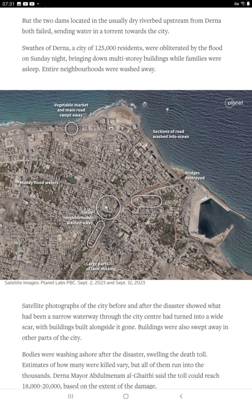

The latest GE images have been updated and if you look at the damage on the river bank it shows that the wall of water was about 20m high coming out of the gorge by the lower dam. Everything under about 12m elevation looks to have been enundatede

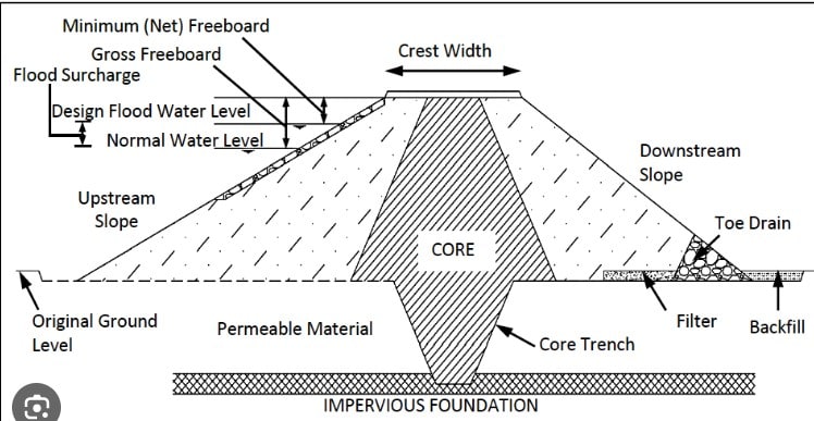

Dam specs, from the builder.
Type of dam: Embankment dam with clay fill
Dam height: 75 m
Crest length: 300 m
Foundation width: 104 m
Embankment: 735.000 m3
Storage capacity: 18.000.000 m3
Dam height: 45 m
Crest length: 130 m
Embankment: 104.000 m3
Storage capacity: 1.500.000 m3
Well ... the one thing they all agree on is the top dam is 1.5 [ponder]
Confusing.
SSCon, Super thanks for the post.
I'll go with that.
I've a feeling that when they say dam height they include the 15 to 20m that they dug into the wadi floor to get some anchorage / down to the impervious layer for the inner clay plug to prevent water leaking und it and de-stabilising it.
So a bit like this.
There is no way those heights are height from bottom of the upstream side of the wadi / normal ground level to top of dam. However dam volumes seem about rightish based on the GE images and measurements.
So about 15 to 20 Mm3 for the upstream / higher up / southernmost dam and then about 1.5 to 2 M m3 for the downstream just above the city / lower down / northern one.
This is a picture of the lower one and shows with the scouring that the wall of water must have been truly biblical in its full flow at some 20m high torrent of water. You can see the trench they dug originally to seal the core of the dam.
