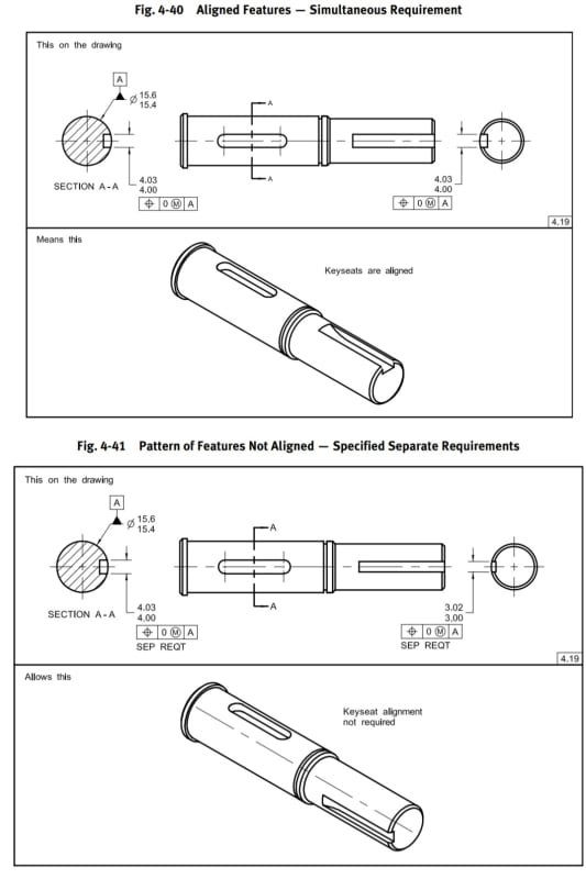

Have you tried seeing how Gom performs at inspecting a simultaneous requirement according to the ASME Y14.5 standard? I am thinking specifically about cases where a rotational degree of freedom remains unconstrained for two requirements that reference the same datums in the same order, but the simultaneous requirement rule has the features aligned anyway, by fixing their tolerance zones or boundaries relative to each other in rotation. See the below figures from the 2009 version. Consider fig. 4-40 (upper case) where the rule applies. Suppose that both keyways were accurately centered to the datum, but much less accurately aligned to each other.
In this case both measured position values could be about zero if evaluated separately (as in the SEP REQT case from 4-41), but they should utilize some more tolerance when mutual alignment is considered.
Ideally, the software would make some rotational "best fit" to find an orientation of the part about datum axis A and both of the aligned tolerance zones/boundaries at which both measured position variations would be minimized. But does it work this way?
