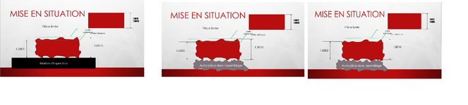

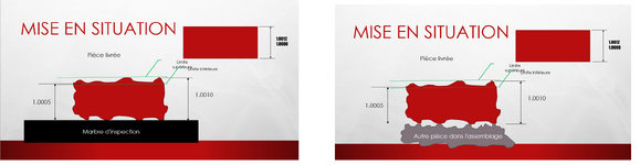

I do understand why we need to control the surface. Below are three PowerPoint slides I show my students to help them understand why a part that works on a surface plate might not work when used. It's in French, but the images are explicit (I am in the French part of Canada and I teach ASME). I was wondering about what value is reasonable, if any.
So, in conclusion, I will tell my students that:
  • There are no standards about how to determine datum feature precision.
  • The vast majority of times, but not always, the precision on the datum is much lower than the precision of the feature related to the said datum.
  • There's a rule of thumb of 1/10th of the precision for the datum, but this might differ depending on the application and risk factor.
  • Like with everything, when they start their career, they should ask an experienced colleague about what they do and why. (Though, in my career, I found a LOT of experienced colleagues who know little about GD&T... I mean colleagues that check parallelism with a micrometer :rolleyes:)
If you feel there's more to add, feel free to write back.
