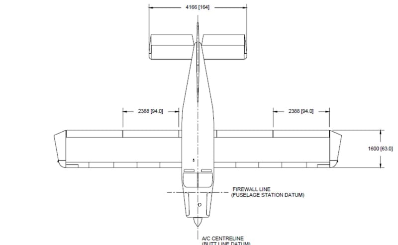

Could anyone help me with a material strenght calculation of this operating horn from crashed plane? 10
RedSnake
Nov 7, 2020
11,739
SE
Picture elevator to the left and stabilizer to the right.
The red cirkel is a tourque tube on the rudder and have a diameter of 38 mm and the thickness is 1 mm.
The operating horn was a welded box design using steel sheet AISI 4130 in condition N thickness is 1 mm welded against the tourque tube.
On the uperside and sides (3/4 of the circumference) has 30% of the normal materiels strenght(severe lack of fusion).
The last 1/4 can be brittle or have been sheared.
The red triangle is the mechanical stop maximum up.
The relationship between hinge, tourquetube and elevetor edge ca..
0 --------1 --------------------7
Can this construction hold for 5,7 G ???

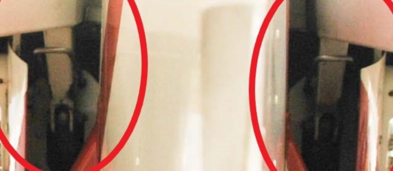

I asked for a picture of the underside of the stabilizer and elevator and got two.
But on both someone has been bending back all the pieces of metal and no picture of it exists before someone touched it ?!
I asked if they measured the hinges for the elevetor .. answer we have felt them ..
I asked that he would check the service manual if these were changed or checked ..
He came back and sade that they were lubricated 70 hours ago the interval is 100 hours .
These hinges are never to be checked in the preflight inspection and the service manual stats that they should be replaced if they become very loose, there is no exact measure of what applies here.

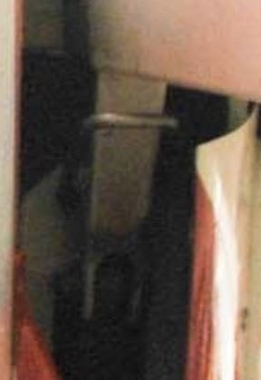

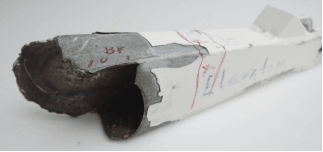

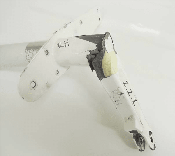

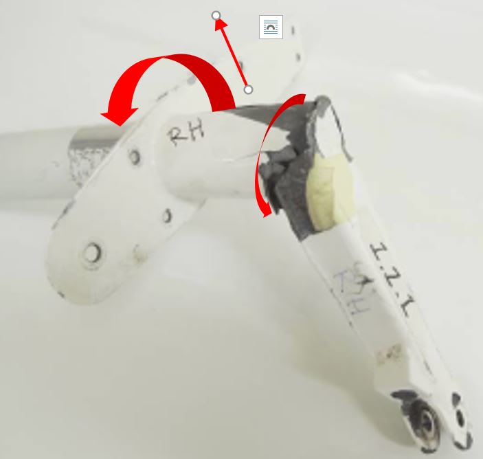

The fracture has occurred at the location were the horn was welded to the tube mounted in
the elevator. The fracture surface showed no signs of fatigue but the overload fracture had
been initiated in a 10 mm long weld defect. The lack of fusion defect extended more than 10 mm.
Effective weld penetration is here reduced to 10-50 %.
This same lever in three different stages of investigation

The photos above are very interesting. The thing to note here is that this item is intended to operate in one plane only and to translate a back forward motion into a rotational motion with zero sideways force.
The failure / breakages on the photos indicate that the joint was subject to considerable sideways bending forces for which it was never designed as the stabiliser / elevator was ripped from the airplane. This could have been better explained for sure in the report, even as an appendix or "other items investigated" section.
When it comes to the altitude thing I think it would be good to know when people talk about x minutes at y altitude what state the persons were in. What I mean is that on the jump run, everyone's heart rate and breathing increases as the adrenaline kicks in and hence you may need more oxygen than simply sitting still. I've seen heart rate monitors on skydivers that hit 160+ just before launch.
In the material report the following can be read, I have asked for a clarification of this because there are many welds around the lever.
The fracture had started in a weld defect of the corner weld. The fracture mode was
overload in tension transverse to the welding direction.
Which means that it has most l[highlight #EF2929][/highlight]ikely broken against the maximum stop up.
It turns and pushes upward at the same time since it is fixed in two points. The hinge in the stabilizer and the maximum stop up.

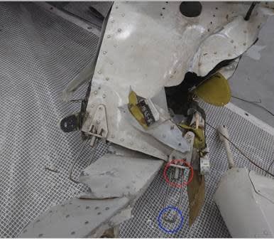

Is that U bolt looking thing the mechanical stop??
If so it isn't the best for sure as it will be generating bending moments in the horn that I doubt it was designed for and / or placing additional load on the horn to torque tube connection.
There was something a little odd in the maintenance manual which said the right hand stop was set and couldn't be adjusted, the other one could be. no drawings are provided.
I still think though that this is a consequence and not a cause.
This is probably due to the fact that on the right elevator there is a trim tab that is to adjust the pitch during long-haul flights so that you do not have to compensate for the oblique blow from the propeller.
So I think it must have a fixed end positions ?!?
I'm pretty sure SHK said both could be adjusted.
And that the ball joint at the end hade a 15 degree flexibilty.

The right stabilizer and elevator had landed before the plane's crash site, all other pices were beyond.
For the stabilizer and elevator to separate from the aircraft, the linkage would have had to have broken at the weakest point.
The pilot may have been able to exert enough force to break the weld, but not enough force to rip the stabilizer and elevator from the aircraft.
Had the pilot exerted enough force to break the weld, then he would not have been able to exert further force on the elevator.
We can say with certainty that the weld was the weakest part of the linkage in regards to the force that broke it.
(This force may not have been in the normal operating direction.)
We can strongly suggest, but not with certainty, that the broken weld was a result, not a cause.
At this point an inspection of similar aircraft for poor welds and evidence of cracking may reduce the uncertainty.
Is it possible that turbulence may have thrust the jumpers to the rear of the cabin and caused an unrecoverable attitude?
Stuff happens and sometimes no-one is to blame?

I know that if things are poorly designed or have manufacturing defects, it is most likely that they will break in the first three months, if they break later, it is often due to fatigue several years later.
But it can only break once, so it could just as easily have been the day before or any other day.
And the reason could be, as I wrote in the terotic description, that the hinges have simply become bad enough that day as an example .. in combination with the ball joint also being worn etc, etc.
This may have prevented or made it impossible for the pilot to sort out the situation.
On the left side, it was the ball joint at the end of the push rod that went off.
I'm not interested in blaming anyone.
I just want to feel sure that it will not happen again.
/A

In this picture, it is clear from wear on the lever that it has been against the stop, especially on the left side. This pictures are not from the crashed plane but from a similar one in Sweden.
