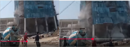

I am fairly confident the collapse was initiated at the base of the core
Sure looks Ike it. The core seemed to drop as a unit, dragging the rest down with it. Which would suggest the core or the footings, or something down at the bottom of the building.
Do we know the direction of shaking with respect to the core? I see the core is at one side of the building.
The post by Sym P.le (Mechanical) possibly has the best indication of the initiation of collapse.
Sym's graphic shows two main features
(1) The first floor was the first to drop down and
(2) Columns failed as a consequential damage and then the rest of the building.
The dust cloud seen poring down while the columns were still intact is very important as this could be the evidence pointing to the connection interface between the slab and column has failed first. If the concrete broke at the connection the whole slab will be suspended in the air by the slab reinforcement. The only resistance left is the shear resistance of the small diameter slab reinforcement or their bonded sections in concrete. There are ample photos showing the pull out of the slab reinforcement.
The next to break was the two inner columns seen here
The column failure could be consequential if the floor dropped down first. The above photos show the two inner columns buckled prior to the collapse. This is because in the design effective length against buckling is the floor to floor distance. However if one floor falls the effective length will be double as its new effective length is from the next floor upwards to the ground. The Chatuchak Building actually has a taller first story but the principle described here still applies. Since the buckling capacity is inversely proportional to the square of the effectively length the new capacity against buckling will be cut down to 1/4 as indicated by the standard Euler buckling formula. The actual buckling formula for the RC column will be different but the fact its capacity relationship with the effective length will not change.
The collapsed building has a flat slab/beam construction which has no conventional beams interconnected with the columns. Thus the only reinforcement connecting the slab with the column, apart from concrete, are just the light slab reinforcement extended inside the footprint of the column. In an earthquake when the flat slab has to move horizontally the columns will be forced to flex themselves to ensure identical strain. However the column is narrow, the slab is a lot wider the bending moment will find it hard to transmit fully from the column to the slab so the interface will break instead. There are ample photos showing the columns were able to break cleanly from the slab. The aerial view of the debris shows more than a dozen broken column pieces each about four to five storeys long all in straight and relative undamaged condition except the two ends while the connections with the slabs have been broken off cleanly leaving the light slab reinforcement exposed.
The above photo depicts a column with 4 floor reinforcement exposed. The damaged condition of the columns generally suggest the slab-to-column interface has been problematic.
This photo shows a column seemingly adequately reinforced above and below the floor as all vertical reinforcement are in place with the transverse links at close intervals. As the usual construction the column section within the floor has no stirrups or transverse links which are required to prevent the concrete from bursting outwards under heavy axial load. The column's floor section has light slab reinforcement exposed but concrete inside has broken and escaped. It can be alarming if the slab/column interface fails the column at the interface immediately becomes a point of weakness simply because it lacks stirrups or transverse links plus the damages from the concrete separation.
This could be an important photo as it shows the vertical reinforcement inside the columns have alternate bars restrained in position by links. The column typically has the slab broken away cleanly leaving only the slab reinforcement exposed. This column upper section has been broken off showing the confining links snap and open up but still has sufficient links attached to alternate bars. ACI 318 Clause 7.10.5.3 mandates every alternative vertical reinforcement in a column to have link to restrain it in position. The site has columns with vertical reinforcement exposed as though they have no transverse links. They are mostly at the position of the slab/column interface which are the easiest to break first. Thus examining other parts is essential in drawing any conclusion.
One way to understand the failure of the Chatuchak Building collapse is to use a pencil to penetrate a piece of paper vertically and then see the effect by tilting the pencil away from the vertical position to see the resistance of the paper/pencil interface. The difference between the pencil/paper scenario from the Chatichak Building is its paper is a lot heavier and drops down immediately when the slab/column interface fails.

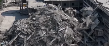

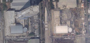

From here and here, we can see that the collapse initiated on the western face, more specifically at the western core wall, and at the lower floors. From here we can see that the lobby level core did not move. That narrows down the options significantly. Bones' hypothesis (here) that adjoining structures played a role is well grounded and further imagery provides ample evidence in support of this. From the freeway (here and here), we can see that the western elevation of the tower at the lobby level plus two floors above is significantly solid infill concrete. Attached, between two levels of the tower, is a connecting structure to the parkade. It doesn't take much imagination to see the devastating impact out of phase oscillations could have on the core. Why did the core collapse ahead of the two adjacent columns? Likely a thousand tons of concrete weighing down from above. The rest is mere spectacle. My condolences to family and loved ones of those lost.

Given the discussion around pounding as a potential cause, to clarify: there were two adjacent structures—one lower structure to the south, which remains intact, and the larger structure leading to the parking lot to the west, which has collapsed. In terms of pounding, the western structure would seem the more likely source of impact. The core was on the Western side.

I'm not sure it took a pounding so much as a push and shove. If the building leans to the east, it pulls out any core wall or column connecting elements (rebar and concrete chunks). If the building leans to the west, the core wall/columns buckle. This gets successively worse with each repetition until the load bearing capacity fails. There are a few videos showing the crane swaying in the east/west direction. Although that doesn't negate a north/south component, it is consistent with predominantly east/west swaying.
