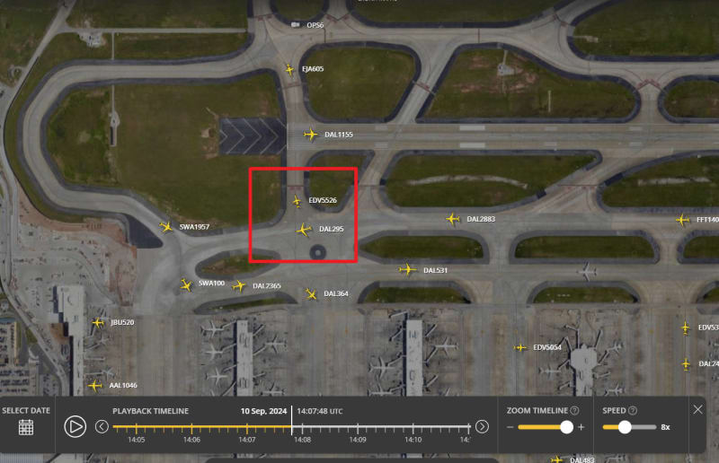

Not sure of the failure mechanism, but there was a runway incursion at Atlanta's Hartsfield Airport
JohnRBaker
Jun 1, 2006
38,130
The CRJ was short of the stop short line when the collision occurred. The next question is whether they were taxiing still when hit (A350 fault) or had they truly stopped short (CRJ fault).

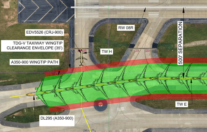

"The centerline of TW-E to the hold short line of TW-H entering RW-8L is 164 feet. A CRJ-900 is 119 feet long and the wingspan of an A350-900 is 212 feet The wingspan halved (assuming the A350 was on the CL), is 106 feet. That's a margin of safety of 45 feet. Somebody was somewhere they shouldn't have been. Either way, the A350 is at fault here. Just find the measurements interesting."

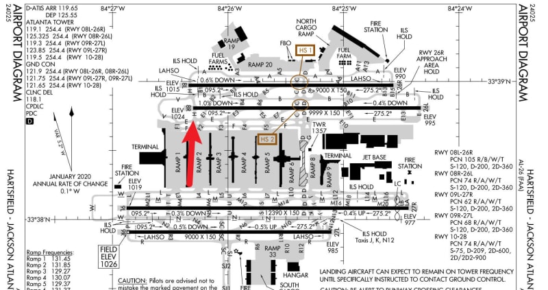

Man that is some complicated runway and taxiway system there.
not possible to really say what was going on there from the photos and videos released.
If anyone knows can you work out where in that maze of runways and taxiways this was?
Not technically a runway incursion. That's when a plane or vehicle enters the runway without permission from ATC. This incident would be a Ground Collision. Both of these aircraft were taxiing (DL295) or holding short (EDV5526) as directed by ATC. You can go back on liveATC.net to hear archived ATC radio with comms between DL295 and ATL Ground. [URL unfurl="true"]https://www.liveatc.net/archive.php?m=katl_gnd_0826[/url] (you'll want ground for RW 08-26). At one point you can hear DL295 say "we just hit something, can you (tower) see what we hit?" EDV5526 will be on Tower frequency for RW 08-26, they don't say much.
I whipped this up this morning in AviPlan. This is to scale. A350-900 is TDG V.
It looks like either DL295 was taxxing north of the centerline of TW E, or EDV5526 was further south of the runway hold position marker for RW08R on TW H. I suspect the latter. Either way, this is a pretty crowded TW intersection.
But as far as the failure goes, I think this one falls on Ground Control. If anyone is interested the current design standard for airports (in the US) is FAA AC 150/5300-13B. There you can read all about runway/taxiway separation, safety areas, object free areas, intersection design, etc.

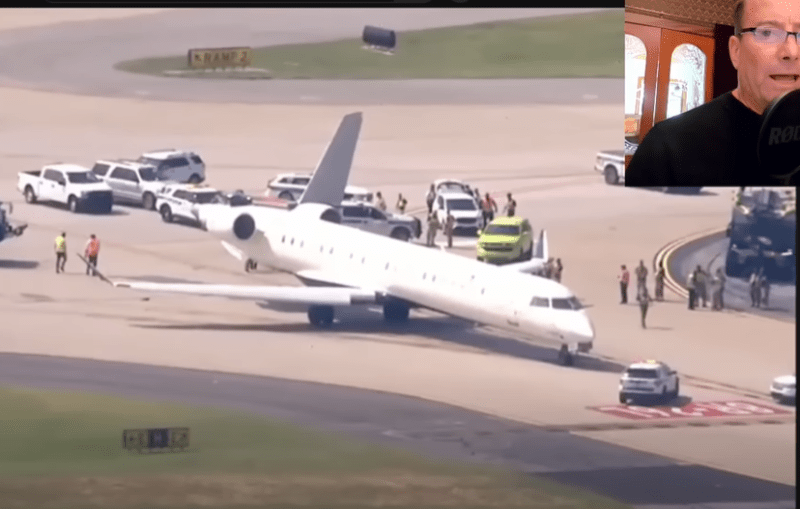

I hope that the CRJ doesn't have a direct mechanical connection from the tail surfaces to the stick.
Ohm's law
Not just a good idea;
It's the LAW!
Per it appears that the controls are via cables going back to hydraulic actuator inputs. In the video it looks like quite a spray of fluid into the engine exhaust stream. Since they operate on the differential between the control surface and the stationary surface, probably the only kickback would be when the tail hit the runway and put a sideload on the rudder.
I wonder if this case was examined as part of any safety analysis.
As the entire tail assembly left the fuselage, lets hope that the force on both cables for each function remained equal and that both cables for each function broke at the same time.
