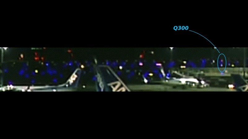

The shimmering at the nose wheel light of the Q300 is likely because of the extreme range of the video. The camera is approx 1.4 km from the incident. I've done a very tight crop of a 2560x1440 video. The flash on the last frame is the very first frame of the explosion. It gets much more intense by the next frame already. I cut it off there to avoid causing epileptic fits.
At that point, the A350 has completely overtaken the Q300.
I suspect its also a frequency thing as well with the lighting V the video camera.

Sym p le, is that 17.46.41 part of the transcript?
And it went unanswered?
So the dash 8 sat there for 30 seconds before being demolished?
40 seconds.
It's not part of the transcript, I was just showing where the video detail slots into the data set.
I wanted to show more of the video however that short animation hits the 20MB limit. I came across the video by accident while trying to download a youtube video using an online service. They offered a higher resolution so I went for it. The video was different than the one I was trying to download.
As you can see from the clip, it is very clear. One only needs to establish which shimmering lights are relevant, and that took time. I'll try to do a GIF of the Q300 lining up on the runway. Stay tuned.

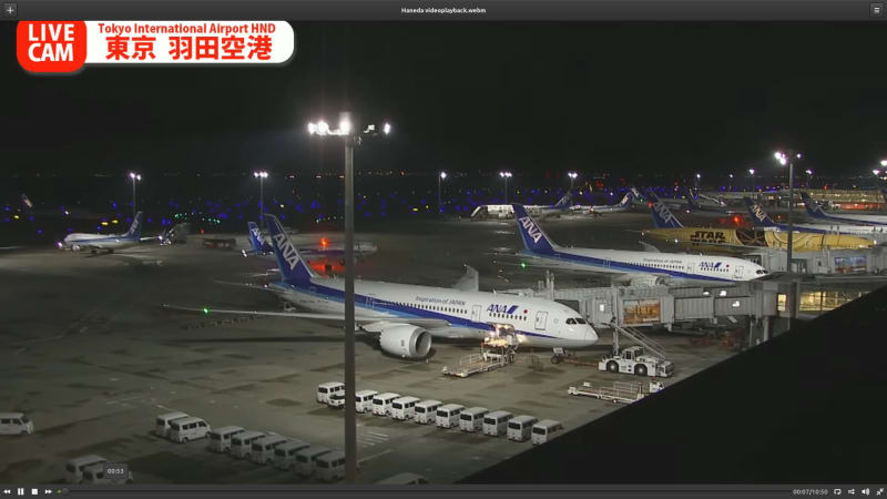

This is a screen grab from early in the video where you can see three large jets parading down the ramp to the C1 entrance. There are also three or four other jets moving about the apron and yet it is nearly impossible to find the Q300 even when I know where to look for it. The "Live Cam" suggests to me this is a public video and there may be more. The incident will be easy to study.

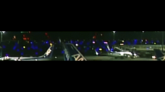

The video is longer than I thought, which is good. Here is a 1:07 clip of the Q300 taxing to position on 34R, sped up 3.3X. It sits there for a full 40 seconds before the collision.

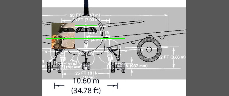

Sym, the overlay you provided shows the Dash-8 wings lining up nearly exactly with the notches in the A350 engine nacelles.

I'm not sure how the A350 plowed through the Q300 but the marks on the nacelle are unmistakable.

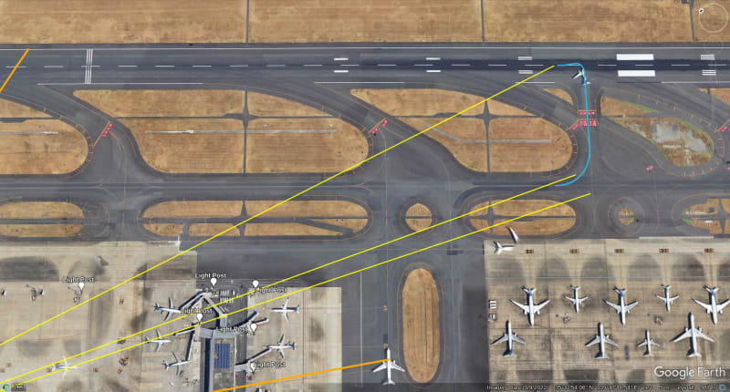

The light posts and known end point suggest the following path of the Q300 taxing if I have the camera location correct. (I have the benefit of a crop that's not as tight)
Also, landing aircraft are aiming for the solid bars on the runway for main gear touch down. The A350 would practically put its nose down on the back of the Q300.

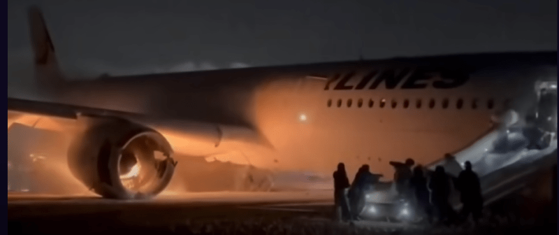

In these videos we can see that during the evacuation the fire was relatively minor.

that isn't a minor fire which is why the hull keeping its integrity to allow the pax to get off I see as a resounding engineering success. And we are told that minor fires eg toilet bin or oven fire or phone/ipad in the cabin have a 7 min window to be dealt with. After that the stats show your life expectancy reduces to minutes.
You can see the engines still running. Which I am sure will be addressed by you engineers.

The primary fire during the evacuation was at the starboard/#1 engine and not at the fuselage. It took a while to get to the fuselage. I see this as an engineering failure in that the engines should have automatically operated the fire suppression bottles and shut down. I wonder if the a source of flammable material was putting the hydraulic pumps on the bottoms of the engines, like did all the damage to PIA 8303.
I'd guess (without knowing the A350 in detail) the engines still running was probably a result of the avionics bay being obliterated, so no ability to control the engine FADEC modules. At least the failure mode is improved over the Tornado F3 FADECs, which would go to full engine power on loss of control power/signal.
