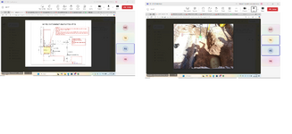

Construction of Foundation beside retaing wall and through existing pipes
krishnandyn
Feb 3, 2025
1
I need to give solution for Plant engineering, where without trial pit , they excavated the foundation and saw 2 pipes as well retaining wall founation is shallow with 10m expansion joint.
How can we safely construct the pipe support foundation without disturbing the retaining wall and pipes.
Please find attached.
Krishna
Attachments
  • 16-RETAINIG WALL.png
    16-RETAINIG WALL.png
    1.2 MB · Views: 16
